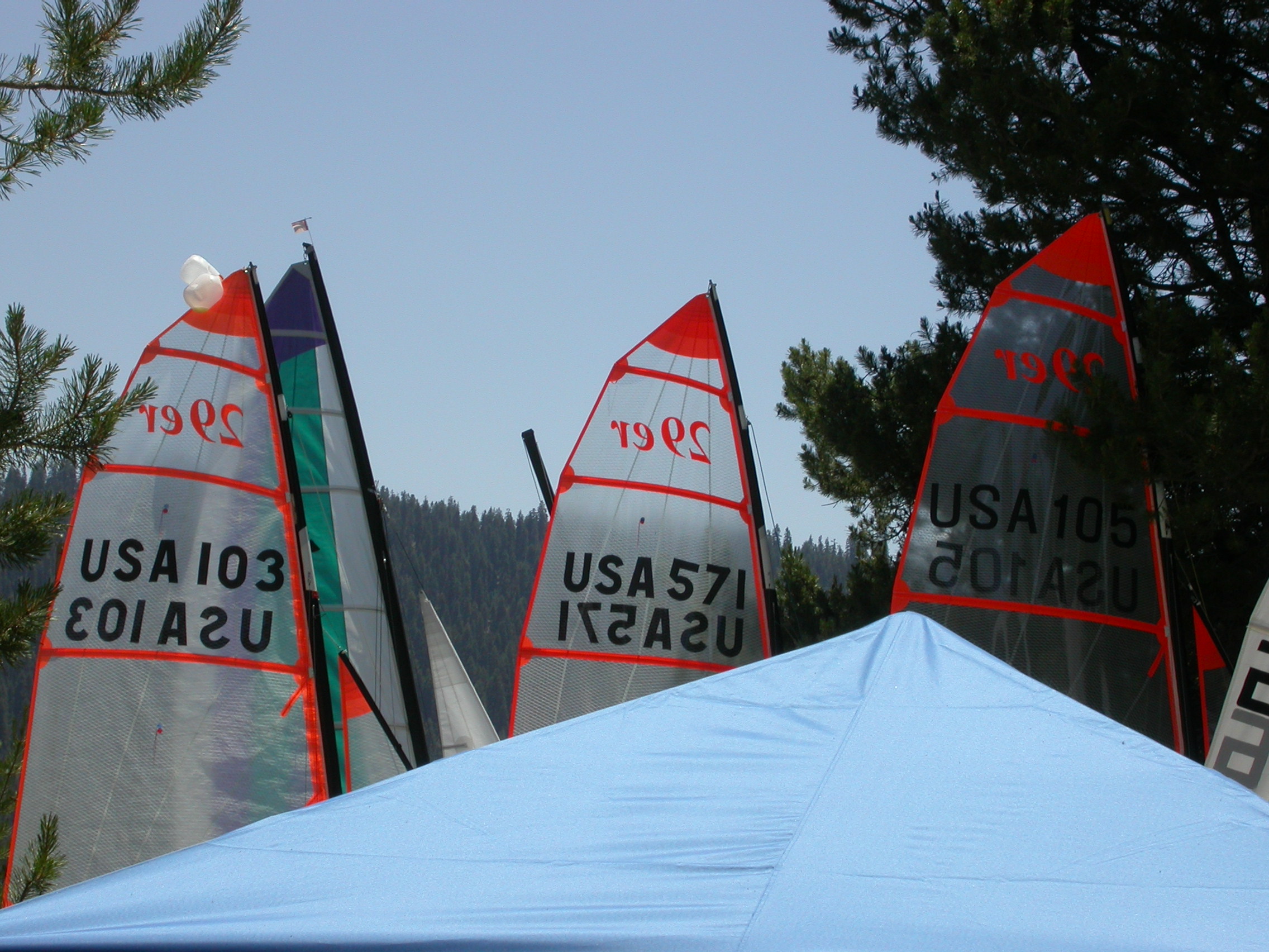

OK - I'll concede that the vang strut thingy does take away considerably to the sheet loads...perhaps the 29'er is not the greatest comparison
Now I'm really lost however, 29'er not a skiff? Sailing Anarchy as a factual resource? seriously? The thing is a pie tin just like the others...so the rig is a little smaller but does that mean that a Hobie Wave is not a catamaran? - the 9'ers are still the same configuration, bow sprit, main, jib, spinnaker, centerboard, and so unstable in the water that it won't stay upright even without any sails hoisted...how is it not a skiff? Wikipedia even lists the 29'er as an example, among others, of a sailing skiff.
It's probably an australian thing. Unless you can trace a direct lineage down from the early harbour freighties and need to be manned by real, hard, tough men, with scars, it is not a skiff <img src="http://www.catsailor.com/forums/images/graemlins/grin.gif" alt="" />
SA is frequented by many true Skiffies and they are quick to jump on anybody that wants to use the term skiff as marketing BS.
Skiff is a class with its bloodlines tied back directly to the old traditional Waterman's boats of the 1800s and earlier. It is not about performance, even though they are at the pinical. It is about history.
If the skiff was not the pinical of monos, than new (not so)High Performance boats would be calling themself something else.
Imagine if in 50 years from now, every boat, any size and spec that adopted hydrofoils, started calling themself 'Moths'. Do you think the Moth class would be offended. Hell yes.
Anyway, this is not a thread for the 'What is a Skiff' debate, so we'll move on.

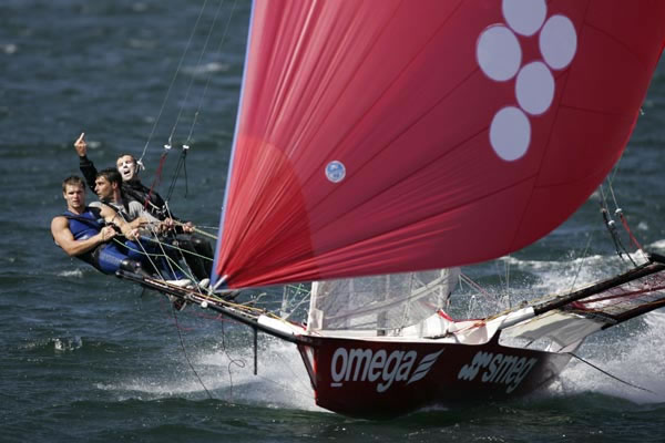

Skiffies have a style you just can't buy <img src="http://www.catsailor.com/forums/images/graemlins/grin.gif" alt="" />

No no Steve, I am sure I have seen that "move" many times on the regatta course <img src="http://www.catsailor.com/forums/images/graemlins/smile.gif" alt="" />

So a "skiff" is not a boat configuration - it's a measure of the testosterone onboard?
They way the terminology is used over here is certainly different. If a boat measured in to the moth class rule, then yeah, it's a moth. The moth is a boat defined by class rules the same way an F18 is. Moth is a "dingy" (I guess?) and an F18 is a "catamaran" as is an I14 a "skiff", etc.
I guess the problem is that folks in Aussy land consider the term "skiff" to not be a reference to the confiuration of the boat as we do in the US and in Wouter-land.

Wouter, on an 18 we don't have 20mins to haul the spinnaker up and play with moving shroud bases. Like TA said, the boat relies on pure grunt; the wing mast could be beneficial if you could figure out a system that worked efficiently. One day someone will, right now there isn’t the need for one.
As the poor bowman (yeah right I love it!!!) on one of these craft I can tell you that the spinnaker loads are out of this world. I have sailed on a F18 with TA in 30+ knots and there was no comparison between the sheeting loads.
The wing mast has been experimented with a long time ago but then was shelved after a fair few of them blew up downwind under spinnaker in 25 knots.
For reference the number 1 spinnaker on an 18ft skiff is approximately 750ft^2. That will vary from boat to boat as the sail sizes are unrestricted.
I have blown up a rig breaker before trying to get the rig tension on and whilst wave jumping in 20 knots on Sydney Harbour snapped 6 of the 9 or so strands which comprise 4mm wire. I think you could say the 18 rig has a fair bit on. Must be off now chaps, lovely chatting to you.

The 18ft skiff rig is around 34' from memory and the bow sprit is around 12ft long. To be fair it is scary how much there is pulling you along. If you do a google image search you will be blown away at the sheer size of the sail area.
