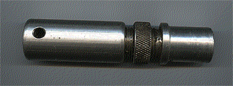

Phill, a 'bottle screw'/'bottle jack' is a loose term I used as a reference to a threaded fitting Nacra used on their rudder cross beam to adjust the alignment of the the rudders by altering the distance between the tillers. I happen to have one here and thought about using it at the beam to push the pole outward to load up the bow lines to help initiate prebend.

I see your point regarding the headsail tack point, makes sense.
What are your thoughts on the bottle screw adjuster?
Bern
