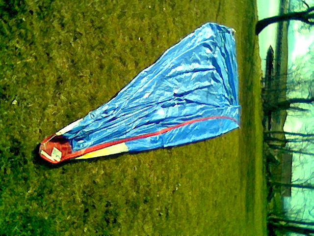

Good idea... I will take some this weekend. I imagine a lot of it probably has to do with the spin being a little blown out, but I will get some pics.
Re: F-16 spi shapes [Re: PTP] #89417
04/20/07 12:20 PM
04/20/07 12:20 PM
Not very good wind (if there were I wouldn't be flying the spin on land!) but here are a few pics...
