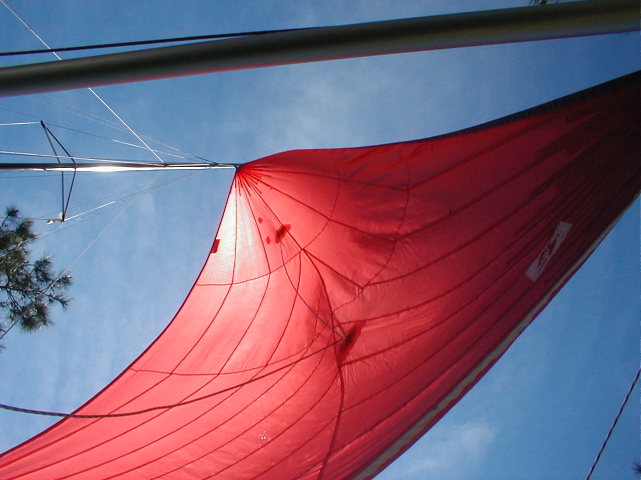

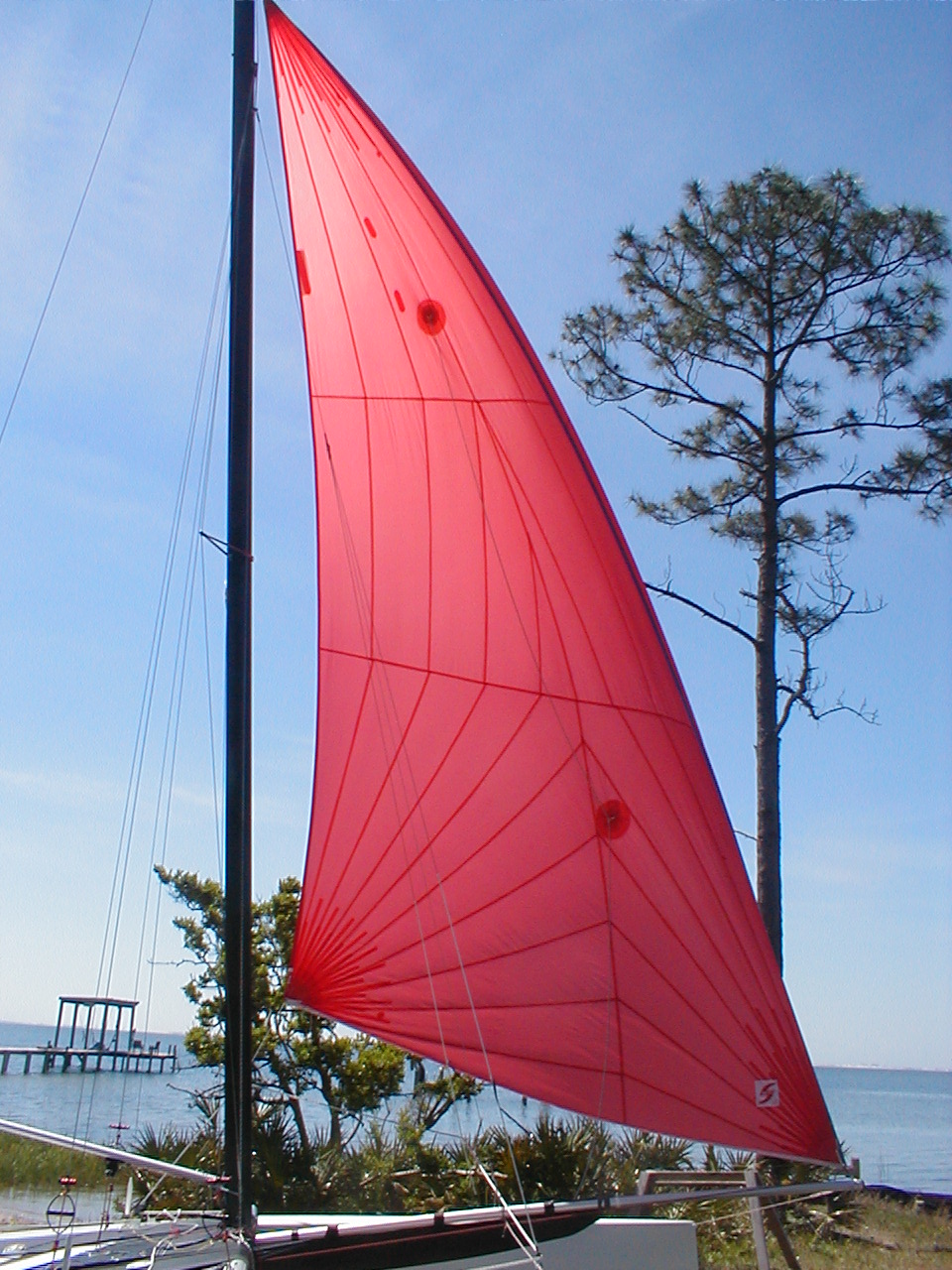

one more...
Re: F-16 spi shapes [Re: PTP] #89420
04/20/07 12:26 PM
04/20/07 12:26 PM
and one more

Rolf_Nilsen Offline OP
You need a lighter retrieval line, that is for sure <img src="http://www.catsailor.com/forums/images/graemlins/grin.gif" alt="" />
The processed image is attached. I had to cheat a little as the seam lines dont go horizontal, and the image was not too good (collapse at the second retrieval patch).
As you can see the measurement show that your spi has a draft of ca. 27% at 46% and 49% from the luff. I would say that this is too deep with draft too far aft. Was your kite trimmed for light wind in the pictures?
Why dont you try lowering your spi pole a notch and see what happens to the luff and shape?
If you want to play with the software yourself, it's available at: http://www.ukhalsey.com/accumeasuredl.asp
It runs fine on all modern windows versions, and under Wine in Linux.

Rolf,
Thats neat stuff. Thanks for the info. The wind was just a shade off of DDW because that was the orientation on the beach already. I think I might take some pics with a little more realistic point of "sail." I have heard that this kite is a fuller kite meant to run "deaper" than others, but I don't know for sure. I would like a little better wind to really get a better pic. The retrieval line is 1/4 tapered warpspeed which could probably be a little lighter but there was little wind. The low wind was certainly allowing the patches to be pulled a little more than normal. As for luff tension, I was able to twist just under 90 deg with my fist. I might try to lower the pole a little but it already seems really low- esp when running through chop and although a longer pole would help, it would screw up the sheeting angle, etc.
As for the numbers you mentioned, what, in your opinion, should the numbers be?
I have a better pic (I think) that I will take a closer look at.
And while I am at it- what really happens to a spin that is "blown out?" Does the draft move further aft?
p.s. sorry that this isn't an F16, but the same principles apply. Next time maybe on the general forum.
