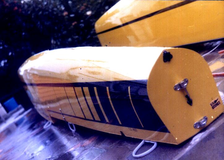

When I've repaired GRP in the past I've always gone 400/600/800/1200 and finished off with G6 cutting compound (fine). For dark colours you sometimes need to follow up with G10. Then buffed with a good quality wax. The results are invariably as good as new.

Yellow and black striped hulls, must have been bees wax <img src="http://www.catsailor.com/forums/images/graemlins/grin.gif" alt="" />
Hey, John, that looks like an old Condor !
At the time (1978) it was quite a NEW Condor! <img src="http://www.catsailor.com/forums/images/graemlins/grin.gif" alt="" />
So what was the giveaway? - The 'Condor 1978' sticker on the transom? <img src="http://www.catsailor.com/forums/images/graemlins/grin.gif" alt="" />
I think it was about 2-3 years old, we'd had a bit of an accident with it and ripped a big chunk out of the stbd hull bottom. The reason for the photo was that I was rather chuffed with the finished repair. Using Jake's 8'/ 5'/ 2' repair standard, it was about a 2" standard of repair! <img src="http://www.catsailor.com/forums/images/graemlins/smile.gif" alt="" />
