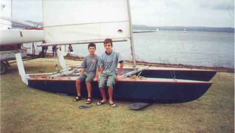

Agreed, the paper Tiger is a great boat and a lot of fun in a breese. You don't need a trap to enjoy yourself thoroughly.
I built one with my eldest son when he was around 12. He was a bit young for it and could only use it in very light conditions.
Actually it was after this project the I decided it would be handy to have a 12ft super easy to rig boat for youngserts 7 to about 14.
Click on the link and it should lead to some pics of the process.
