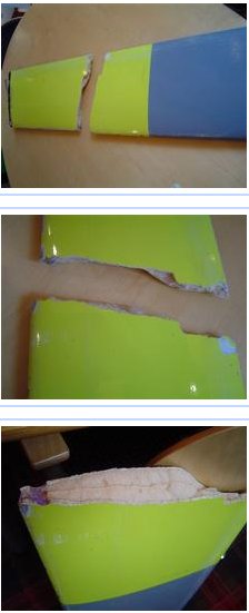

We broke a rudder blade going to C for the first time during Race 1. Stuffed the bow, bore off and heard a huge crack. Same puff (or very close to) the puff that pitchpoled Chuck and Mavis. We didn't pitchpole but came to an abrupt halt long enough to see both Chuck and Mavis with the boat and working their way onto the hull. At that point we were close enough to see Matt/Gina and Seth/Stefan round C mark. We rounded C mark, but obviously had helm problems the rest of the race (the starboard rudder was flexing back and forth) and quickly lost contact with the lead boats. We were able to finish Race 1 in third place and start Race 2. We made the first triangle of race 2 (again, not competitive due to helm problems on port tack) and almost all the way back to A when the pressure from the broken starboard rudder popped the port rudder stock off the top pintle. We made our way back to the beach and scavenged a replacement rudder blade from Matt. We did notice the port rudder stock had a small crack on the lower portion (where the lower gudgeon pin goes in). We hoped it was only a surface crack.....
Sunday was rainy and blustery. We loaded the rudders back on, rigged the sails and got in line to get off the beach. It was downwind to the start so we put the spin up as we were a little late getting off the beach. As soon as the spin filled and loads were put on the rudders - BOOM, the whole port rudder casting exploded off the boat. The lower part of the rudder stock was ripped from the lower gudgeon pin. I guess it was not a “surface crack”. Done for the day/weekend.
We sailed the boat back to the beach using the tiller arm on the leeside for steerage. That was fun in the breeze. Loaded the boat on the trailer and headed home.
It was nice to see everyone and get some 80 degree sunshine, wish we could have participated in more of the racing.
Engineering questions:
1. Is it plausible that the broken starboard rudder caused the rudder stock problems on the port side (rudder stock popped of the top gudgeon pin and eventually complete rudder stock failure)?
2. We looked at the starboard gudgeons and they looked to be slightly misaligned (not much), but enough to distinguish with the naked eye. Would rudder not exactly in the vertical plane or not matching the port rudder’s plane be more apt to break? I’ll take some pictures and post them when I can.
I’d like to find out the root cause as to breaking the starboard rudder, as this is the second one that I have broken. Being the starboard rudder could be coincidence as both happened sailing downwind under spin on port tack in heavy wind.
It is entirely possible that my “technique” for bearing off was/is a little too radical and not as smooth as it should be. Heck, I was just trying to avoid an ender.

Sounds like something funny's going on with those rudders. Where are they breaking? And did they both go in the same way?
Sailing with one broken rudder would mean putting more load on the other rudder in order to get the same movement, but even so, I'd expect to have to seriously abuse a rudder to get it to break (short of hitting something, obviously).
Have you checked the rudder rake? If you've got them raked way forward under the boat, that might explain something. Someone on this forum talked of forward rake causing breakages (Rolf, was it you?), but I would have thought you'd have to use ridiculous rake for this to happen.

The breaks were internal right at the hole for the raising/lowering point (hole drilled through with a line going through it) and right under the bottom of the rudder stock. No "real" outward facing damage until we sailed with it for an hour or so and the head split at the seam. The rudders continue to evolve in their construction method. I guess there is no "Tom proof" carbon rudder yet. <img src="http://www.catsailor.com/forums/images/graemlins/smile.gif" alt="" />
Not passing judgement on any parts, but I need to know if I have a setup problem that I can correct. When I get everything back together, I will post pics of rudder rake, alignment, et al. Until then, we can only guess at the underlying issues.
I'm certainly not an expert in blade construction, but is that hole sealed in any way? If not, would it not let water into the core of the rudder, causing it to be come soft? That point in the rudder is going to be under serious load.

I believe that the additional holes for the "line based" raising/lowering system may be the culprit. There are actually two more holes in the rudder blade in that system rather than with the "rod" system. One hole drilled for the stopper knot and one hole drilled 90 degrees to that so that the line can be fed out of the rudder, up the stock and to the jam cleat. These holes are located just below the bottom of the rudder stock - where the loads would be quite high. I believe the newest rudder blades are solid core construction, instead of having some internal foam. My rudder blades were produced right after the US switch from "rods" to "lines", so they may not have been suited to that change.
BTW, Vectorworks as been great about sharing improvements and open to frank discussion about the product. I sincerely believe they are close to getting all the right pieces in place. My only problems have been the rudder blades and my problems may be more related to the timing of my boat delivery than anything else.
Re: Tradewinds [Re: tshan] #96256
01/17/07 03:42 PM
01/17/07 03:42 PM
I once repaired a sheared off A-cat daggerboard for a friend. He hit a large underwater rock on his first outing with the boat, and the daggerboard sheared off cleanly below the hull. When removing the pain and some glass for repair, it became evident that the manufacturer had drilled and filled a 10mm hole at the leading edge. The shear started just at the hole, by design I suppose. Much better to break the board than cleaving the hull.
If you look at the bottom picture, you can just make out the hole at the leading edge in front of the light foam.
