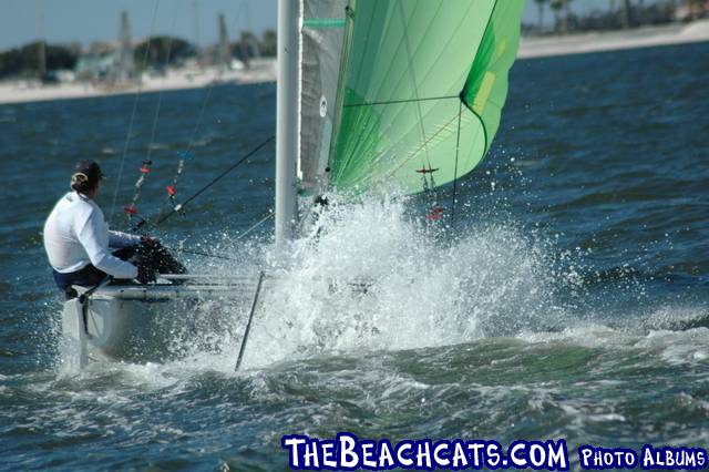

When I look at this pic, I can't see any knots/line changes. Is that because the knot is on the tramp? Is this knot the reason that the lazy sheet looks short?
