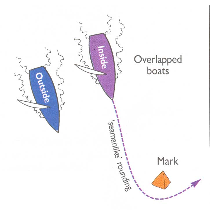

What is it?
If you enter the mark wide and exit close to the ball as most of us are taught ( "C" mark in this example), you risk cutting off another boat who enters close and exits wide.
Who owes what and to whom?

if there was no overlap at the time the first boat entered the two length zone at NO time is a boat authorized to get between you and the mark. You are allowed to round in any method you see fit as long as it is reasonable. Entering wide and existing close is definitely reasonable. If someone sticks his bow in when you do this, he should avoid contact with you and start humping the mark. If there is contact, or you have to avoid in any way, you have been fouled. Obviously, you too should do you part to avoid contact but you should be proudly proclaiming "no room in there! - no overlap!" and then "up up up!" followed by "protest" if he stays on the inside, causes you to avoid him, and/or hits the mark.
If you are behind, occasionally you can sneak one in on the inside of a boat ahead who might be floundering as they attempt a rounding - but you better be sure they can't come up and pinch you at the mark - you are in no-man's land and have no rights.

What you have described is a "tactical rounding", not a "seaman-like rounding".
Seaman-like means that you just have enough room to round. According to US Appeal 20, “Room is the space a boat needs to pass the mark in a seamanlike way, not the space she would take to pass the mark in a tactically desirable manner.”
Assume the same relative position, but no overlap. Then what?
If Purple were to have no overlap here (When the first boat enters the two-length zone). Then he has no rights. Blues only recourse is to protest Purple. However if purple takes the inside anyway blue must still avoid hitting purple and protest.

Agree. As shown in the picture, can't the inside purple boat round tactically?
No they cannot. Only when you are clear of any obligations can you do that. Inside boat must round in a seaman like manner, not tactically.

But then in the pic above, why not a tactical rounding according to what Rick said?
"If there was another boat in the zone at the same time and a boat has INSIDE overlap and is also the right-of-way boat, (Occurs when either both boats are on starboard, or the hero is on starboard and other boat is on port) again he need not do a seamanship-like rounding, rather a tactical rounding."

But this doesn't mesh with what rick said, right?

If you have right of way and inside overlap you can make a tactical rounding.
If you don't have right of way but you do have an inside overlap you are only given room to make a seamanlike rounding.
Basically once you establish the inside overlap you still need to think about whether you have right of way or not.
Purple can't round tactically because blue has right of way (leeward boat).
