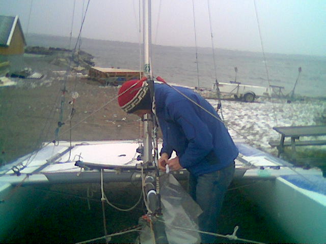

Glorious spring? Not on our side of the north sea, we have snow, hail and wind, and lots of it! Attached is a picture taken on friday, while rigging our new snuffer bag. No need to say that the club was deserted I guess.

Here is a picture taken today:

I am a bit confused over what kind of line you are going to use. I take it you are thinking about a double braid core (spectra?) with regular nylon cover, and not a pure double braid with no cover.
Since we installed our first snuffer we have stripped the cover off the retrieval end of the halyard. The first trips out we ran with the cover on, and had burns on the spi panels where the friction between cloth and line had been too large. Since we stripped the cover off we have not had this problem to the same extent (far from it). When stripping, you should at no point remove more of the cover than you absolutely have to. The core is very slippery to handle, and if you sail singlehanded, it might be worth it to keep the cover on. On our last halyard/retrieval line, we removed the cover from the tie-in on the spi patch and down until ca. 1 meter from the foot of the spi. That way we minimized the length of core to be handled when retrieving. It's far better to err on the short side than the long side..
Others (like Wouter, I seem to remember?) have had no issue with keeping the cover on for the whole retrieval line. We discussed this at length some time ago, so if you make a search here on the F-16 forum you might find more opinions. Hope I understood the question correctly.
