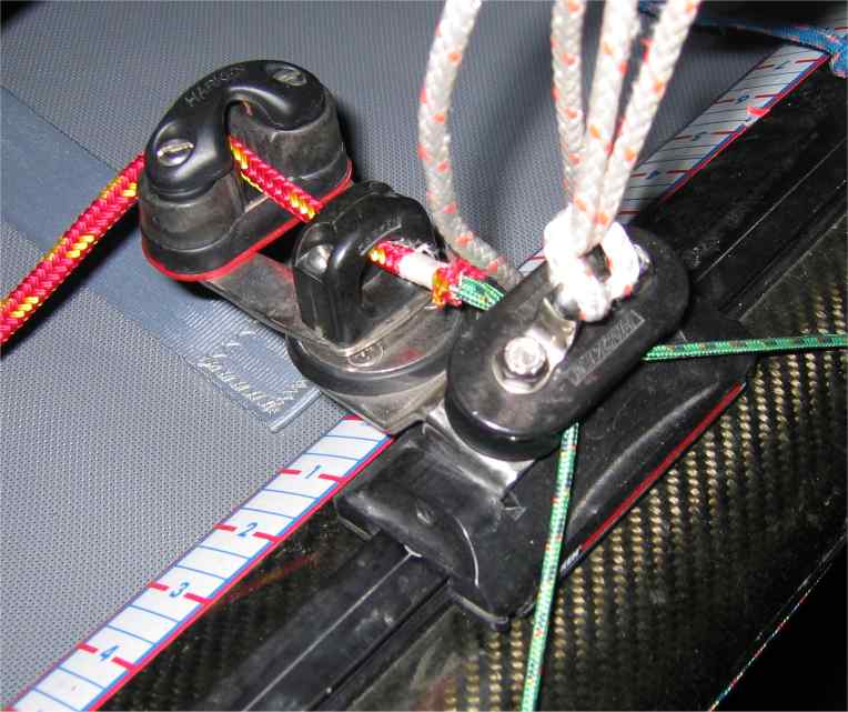

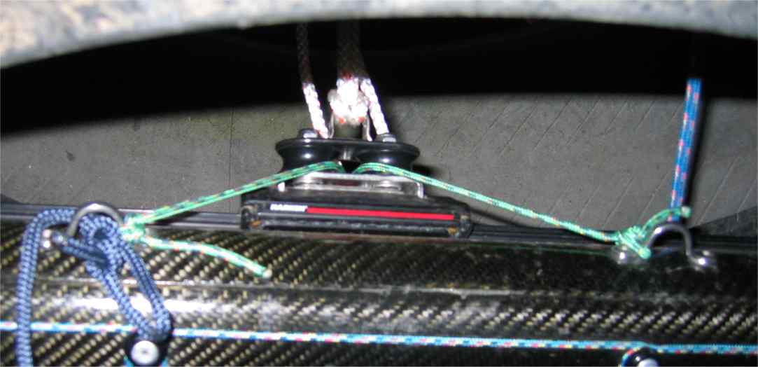

Thanks Eric, that explanation makes sense, it does seem that it's a small improvement, but that is what the A is all about. Enjoying it immensely! Pic attatched.

Doesn't that allow some slippage letting the traveler fall off some?

Yep; I'd thik so;
Mine is made thus:
Take 8mm I think and remove the core; then thread folded over 3mm thru it, sew and then bingo!
from below and from aft:
From Above
Sorry about the tyre etc, boat is poacked up for Mumbles <img src="http://www.catsailor.com/forums/images/graemlins/grin.gif" alt="" />
I'm guessing that the black cord is elastic, so pulling hard pulls the bowlines against the eyelets. An elaborate setup, and I can't figure out what it's trying to achieve.
For the system to be of any use, the join in the rope needs to be in-board of the rollers on the traveller car, as in Simon's set up.
That black line is not elastic, I can't see why it would be. Doesn't make a lot of sense if it were.
It can be difficult getting the proper distance to make it work.. but youa re right, needs to be inboard. I usually run mine up to the rollers... but I am going to change it. Problem is the chafe at the point where the core comes out of the taper. But I like Simon's set up
