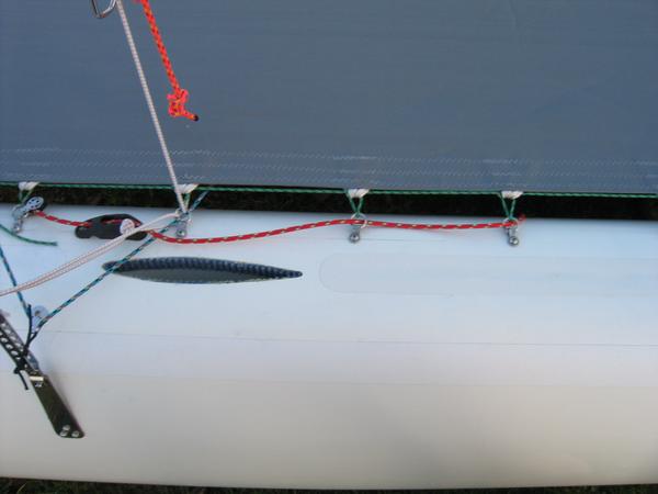

Question, "fire and foreget rotation" ? ? ? How does that work ??
Will_Lints
one-up, Blade 706, epoxy bottoms
Sounded like a good idea at the time....But I've not sailed the boat enough to work out if it helps.
I have 2 systems for controlling the mast rotation.
Course tune: rope goes from the side decks, then under the tramp to a hole and then up, thru a block on the end of the spanner and then back down and to the other side; this is the "course" tune that allows me to dump rotation at the windward mark as the spanner will rotate to the max.
You can see the cleat and turning bock on this pic:
Fine tune: There is then a second system for fine tune (upwind) where I have a pair of cleats on the mast spanner and a second (blue multi coloured) rope that leads to the shrouds.
You can see it clearly here and you cal also see then end of the red rope coming up thru the tramponline
So get around the windward mark and let the mast swing free by uncleating the red rope on the side.
At the bottom mark, you pull the red rope and you go back to the same setting you had at the windward mark.
you can then move mast rotation at by pulling the blue rope from the wire.

Scooby S
On the red line course adjustment, is the cleat what Ronstan calls a "V cleat" and if it's released when you hoist the chute and jibe after you snuff then can you get the red rotator line to catch from the new windward side....?
And 2), does the blue multicolored (coloured) fine adjustment loop back to the other side stay...?
It looks like you have some good ideas here, mine is not satisfactory as I tend to sit on or bump the cam cleats as I'm tacking and in high winds that's a problem.
Will_Lints
Re: Leading the Charge [Re: WillLints] #104504
04/24/07 02:03 AM
04/24/07 02:03 AM
Scooby S
Yes, there is a V cleat both sides and so the line is double ended; you will notice there is a double ended block on the spanner (red goes round one block facing down towards the tramp, blue around the other).
Yes, the Blue multi line goes to both side stays so you can adjust the rotation from the wire.
That would only allow you to pull it on, and anyway there is another cleat on the other side...
Well that was my thought. I'm probably missing the point (Oh where is "the master of the obvious"?). When tacking especially after a spinnaker run I seem to have more to do than I have time or energy. If I can manage to stay out of the water then I give my self a little congratulations. That is until I look over and see the anti rotator is free and I'm trapped out or about to. I don't know if I would need the cheek block to allow me to engage the anti rotator from the high side or weather yanking on line (red) that is running under the tramp would be enough to engage the 'V' cleat. The system that I'm envisioning would replace the 'V' cleat with a swivel cleat, probably cam cleat, so that I could adjust the mast rotation from the wire.
Are there any links to Greg Goodall's F18 rotator that TwiceBitten is referring to?
