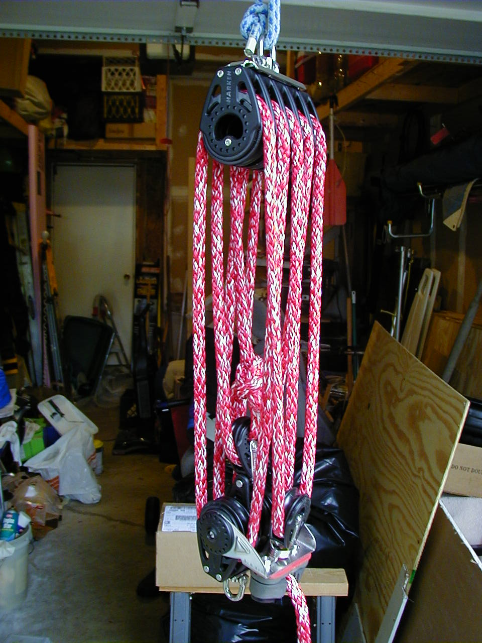

I just received my new Harken 10:1 system. Last night I sat down and tried to run the sheet through it. After several attempts, I got it to look like it might be right. Does anyone have a diagram of the correct way to run the sheets through the blocks? I checked the Harken website, and it only shows 8:1. I even bumped into a friend of mine who works for Harken last night to ask him the correct way. He had no clue.

Ours was a bit different than that pictured in this thread however. This is what we ended up with (it took two engineers an hour to get it right).

The 10:1 harken block that came with my Infusion had a double block attached to the becket above the cam cleat right out of the bag, and that is how a ran the line with the top block 90 degrees to the bottom. Seemed like it would work good sitting on the couch. I soon found that the double attached to the cam cleat becket didn't pull on the top block evenly causing it to twist and the lines to override.
Fortunately, the boat Mischa raced at NAF18 last year no belongs to someone in the same club. So with that as a model, the double block is attached to the top becket of the lower blocks, not the cam cleat becket. The line is dead ended to a becket on the double. Surprisingly there is plenty of room in there. That my story.

Here's what we ended up with, and it works well, no binding. The trick in figuring it out was to make sure that the loads were centered in both blocks, otherwise lines would jump the sheaves. When I wne to do this the pics that were on the forum before couldn't be accessed (haven't looked again since), so this was a trial and error routine, but it didn't take long. The pics probably don't show it too well, though. And, yes, I need to clean out my garage... <img src="http://www.catsailor.com/forums/images/graemlins/smile.gif" alt="" />

On my 8:1 the top and bottom blocks are oriented at 90 degrees. It appears that is what the two engineers came up with also.
