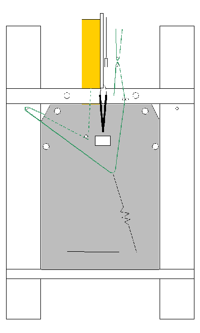

Retrieval line
I think the grommet in the trampoline caused relatively alot of friction so I have stitches a small block underneath my trampoline just at the rear of the snuffer bag. Another block is attached on my port mainbeam just next to the opening between the hull, my trampoline and the mainbeam. Naturally I lead the retrieval line through these blocks and like that it passes from underneath my tramp to above my tramp. The partion above the tramp I lead through a large stainless steel ring that is tied to a bungee cord coming from the startboard rearbeam (more like a attachement point on the tramp near it). After the retrieval line run through that it goes straight the the cleat on my mainbeam. As such the retrieval line makes a large V on top of my trampoline. Works great.

Wouter, I like your retrieval line setup (and the excellent diagram). It's a good solution, going through the gap at the front side of the trampoline did not occur to me! What are the pitfalls of fixing a block to the underside of the tramp? How do I punch a hole through it without having the tramp self destruct the first time I pull on the retrieval line? Is there a how-to anywhere on how to sew such a thing?
Also, about this setup, I'm guessing that the shock cord is tensioned only when the spi is down, and slack when it's up to avoid putting pressure on the retrieval line? Am I right in assuming there is a 2 in one line pulling the spi tack in place giving you enough additional halyard line to relieve the shock cord pressure?
