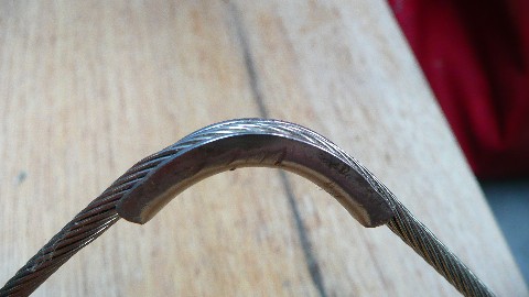

Here is a neat way to construct this kind of bridle.
It's just one piece of wire (I think about 2.5m is a good length) with a piece of a thimble clamped (with a vice) in the middle to give the rope something bigger to bear on. The thimble is a large one designed for 4 or 5mm wire - the centre part is cut out to get the desired radius.
I have wondered if it would work without even bothering with the thimble. It all depends on how the rope handles being tied around the wire.

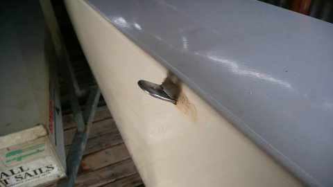

I wasn't quite sure what you meant by Horizontal. Have attached a photo of where mine are... think it should be OK?.
I noticed during my recent repair and repaint that my starboard hull has had a repair done previously, inside @ front beam. The repair seems to have been done very well however I'm thinking it might be wise to leave putting a kite on till I can afford to deal with the possibility of breaking both bows off.<img src="http://www.catsailor.com/forums/images/graemlins/shocked.gif" alt="" />

Your chainplate is aligned vertically, whereas mine lays flat as it comes out of the hull.
So yours is ok. If I put a high cat-rig bridle on mine it would bend the chainplates upwards and damage the gelcoat (and maybe worse) around it.
