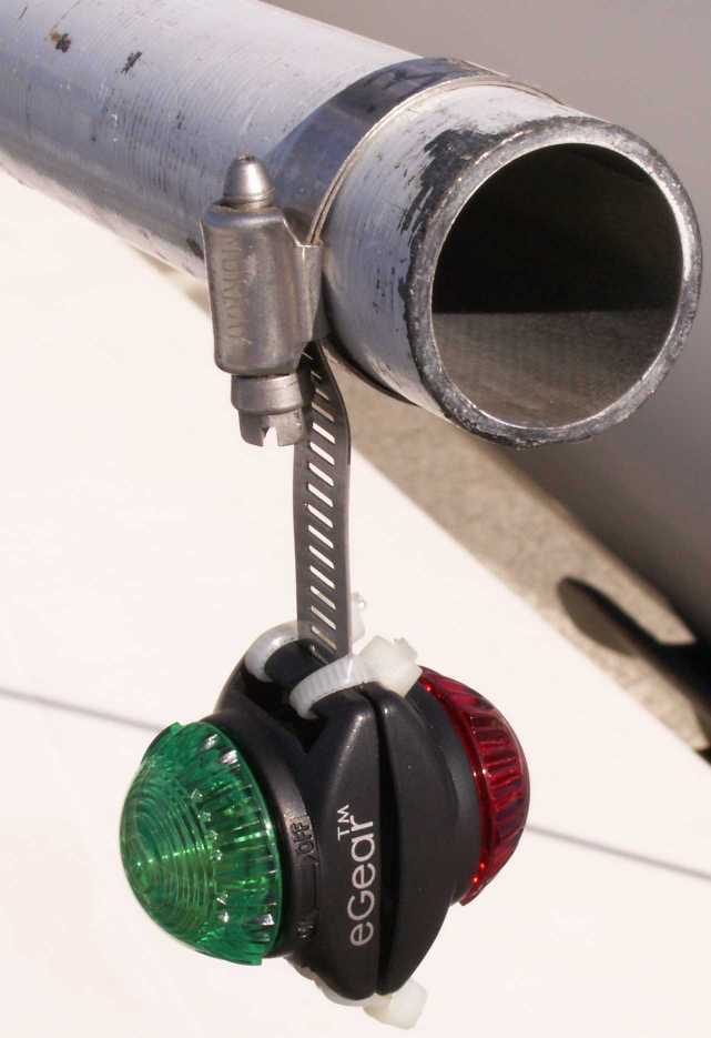

I'm going to go with Adventure Lights.
[Linked Image][Linked Image][Linked Image]
They go for 250 hours on a battery pack that costs $1.50 USD. They have slots on them that allow you to place a green and a red one, back to back using plastic tie-wraps or whatever fastener you prefer.
They weigh almost nothing and are securly sealed with an O-ring. You twist the lens to turn it on or off.

Here's my quick installation for my bow lights. It is a stainless steel hose clamp on my spinnaker pole. I am going to build one that will snap on and off of the pole. In cross section it will look somewhat like the shape of a question mark.

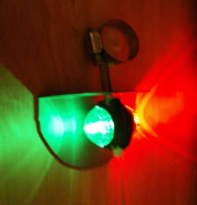

Backing plated added to prevent light from being seen from behind.
