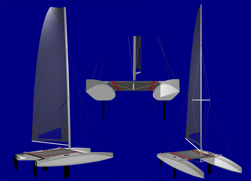

Mark II CTMD F12, sorry I'm not as good on rhino as RG. Jeff, yes you could use rotating centre boards, however I will show daggers as standard. [Linked Image]

Chris, since you've stuck with a stayed mast and dolphin striker, are you considering the possibility of a trapeze?
And target crew weight is still 45-50kg, yes?

Mark,
target crew weight is still 45-50kg (I've left some extra freeboard in to cater for heavier crews or two people).
The concern with trapping is the extra compression load applied to the rig. The rig I'm looking at is designed for a two person, one on trap dinghy (MG14). With a 60kg person hiking on the cat the mast will experiance similar loads to what it would see with one person trapping on the less stable mono. I've gone with this mast at this stage because its similar in shape to most modern cat wing masts and because fully rigged it will be less than 6kg (a weight that will enable kids to rig their own boats). If you wanted to be able to trapeze its only a matter of talking to whoever you buy the extrusion off and discussing what section they would recommend (you'll propably end up a couple of kgs (4lbs) heavier at the most). The beams and dolphin striker as specified would be fine.

Ok thanks Chris. Presumably no expectation that trapezing is required from a righting moment point of view.

Hi Scarecrow
I actually really like the look of that, without me trying to study between the two, what changes have you made in regards to Mk1 to Mk2.
I'm all for centreboards and stayed rigs, I didn't have any trouble throwing up an stayed rigged aluminium rig when we were kids.
Are the plans available for this one? Also include a set of plans for a bigger shed, I think I'm gonna need it <img src="http://www.catsailor.com/forums/images/graemlins/grin.gif" alt="" />

mk II
LCB 46.6%
LCF 42.4%
Cb 0.475
Cm 0.885
Cp 0.639
Cwp 0.721
For those who are a little new to this. Traditional theory is that keeping the LCF and LCB as close as possible will minimise pitching and keeping the LCF as far aft as possible will help prevent nose diving.
A high Cp is traditionally considered quick and a low one is considered easy to turn.
Matt Plans and kit are coming on line over the next couple of weeks (see pricing thread) the price will be slightly lower for the kit as I've eliminated one sheet of ply.
changes between two versions are a basic tidy up (first one was done very quickly) and a reduction in freeboard and some tweeks to the internal structure.
Chris.
