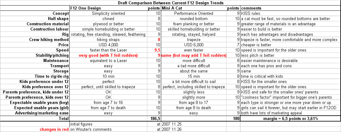

It might not be necessary to assume that a trapeze version goes with the round hulls and higher construction skill.
Agreed. The end of the process is to add all positive features we can to the best concept, regardless their origin, but sticking to the chosen concept.
I note that your spreadsheet indicates a target age range that spanning both Wouter's original target and the younger kids that others favored. Not sure if this is generally agreed by everyone else. Still interested in knowing the ages of the kids RG is talking to.
Yes, but note that I am spanning the original age range with two up.
As Wouter wrote, a cat that is optimal for 12+ year old kids is also a very good choice for a couple of kids under 12. This adds a very important marketing feature to the class, for then it will be a strong replacement/competition for both the Optimist and the Laser - while interfering little with the original goals.
Also, note that this is a tough feature to replicate in a monohull class: a Laser can be sailed by two small kids, but it is hard for them to keep the boat upright when tacking and jibing (have you noticed the high beam of the Optimist? It's no coincidence).
The cat's high initial stability makes life a lot easier for the small ones. I think we must use this advantage in our favour as much as possible, if anything because we can't get read of the inherent disadvantage: the tendency to go to irons when tacking.
The trapeze is a source of interference with the original goals. If we accept that it is indeed advantageous for the class to target this segment (startup boat for ages 7 to 12), we'll have to analyse this feature carefully, for it leverages the advantage that kids over 12 have against two smaller ones.
Also curious whether "one design" is still the consensus. My impression was that Chris and RG are both pursuing separate designs with the expectation that they will both fit into the box rule defined by the measurement form they put together.
Good point.
The problem with a formula is that parents start competing to see who spends more on the kid's boat. This forced the Optimist to become a strict one design. Even with the narrowest possible rules, parents still find ways to spend a lot on their kids to give them an edge (buying high tech lines, gore-tex clothes, multiple foils, sails and hulls, etc.).
This is another interference caused by the increased age span. Younger kids' parents require strict one design rules, while older kids (and their parents) can live with a formula - and possibly have more fun with it.
As a consquence, first we must discuss if the "two up under 12 startup" use is a desirable feature for the class or not. Needless to say, I favour this feature. Here's why:
Even with Internet, I don't see a group of teenagers managing a Formula class. In most of the cases it will be their parents doing the work.
If parents must be involved, why not catch them earlier, at the same age kids start sailing Optimists? It is easier and it makes more sense to me.
If the class is sailable during a wider age span, the class organization becomes stronger. Parents managing the Optimist class usually help for 6 to 10 years, maximum. If the same boat was good for a couple more years (as would be our case), they would help for 8 to 12 years. We all know how difficult it is to find people to help, so this is a great benefit for the class.
I'd like to hear what others think before continuing, because I may be trying to convince the converted...

...if I follow exactly what those interested want (not counting those here), its a hard chine design, with boards, that can fit an age range from 7-8 thru 16+, that can accept either rig, although the majority appear to want a stayed rig.
I guess the design could be made to accept either rig, obviously at the cost of adding specific structural reinforcements.
Can you estimate the weight increase, if significant?
The two configurations are:
- "School" configuration - free standing mast / two kids under 12 / hiking straps.
- "Competition" configuration - stayed mast / one kid over 12 / trapeze.
The question remains about the type of class rules: one design, formula or split? (split meaning one design for the "school" version and formula for the "competition" version).
If the class rules are made different for each configuration, two classes will be born - and in the end one will be a strict one design and the other a Mini A.
I guess this alternative can be excluded because (as I see it) we want to converge to one optimal class rule and/or design.
If one rule covers both configurations, it's one class with two purposes, much like the 420 (a one design class with two configurations: "club" and "competition").
Another argument I found against trapeze is that is does add cost beyond its direct advantages. Mostly because you have to buy a kids harness which he or she will grow out of very quickly necessitating maybe a new harness 3 years down the line ? These kids do grow at a pretty impressive rate. In the end it is just another thing to buy when a kid starts out sailing these and it all adds up in my opinion.
I figured that it was better to just add a little more width to the platform and hike to get to the same overall performance.

My comments on your spreadsheet.
I would like to add a few comments on the "OD F12" in your spreadsheet.
Trapeze/Hiking :
The given 7.00 sq. mtr rig on a 6.00 mtr mast (that is what we all agree upon right ?) will only be able to produce so much heeling moment. The OD F12 will resist this by hiking on a wide platform, while the trapezed F12 will resist this on a trapping on a more narrow platform. You don't win much by trapping on a wide platform, mostly because the rig will then not have you trapping unless the winds are really strong. That was the idea behind the hiking OD F12, just add a little extra beam width to compensate.
From memory I think that my design achieved 2-up trapping F18 equality at 2 mtr wide for a 53 kg crew.
Speed :
From what I know and have seen on the water, many will be surprised about how small the performance difference between a multichined and a round bilge hull will be when all else is the same. We are not talking more then say 3 minutes per hour racing at max here, which is pretty negligiable.
Stability/pitching :
My F12 design was to be fitted with T-foil rudders, especially the deep V-ed keel version. In my opinion this is the most simple and inexpensive way to get excellent pitching behaviour. As per what Darryll did with his F14's, the T-foil rudders use plain kickup rudderstocks. On the F12 the rudders and T-foils will be too small to develop enough force to break off the sterns or stocks anyway. On the Alfa Omega F14 did was already the case. As such the little T-foils are just permanently screwed to the bottom of the rudders. Plain and simple, easily replaced when damaged.
I think these points will increase the points assigned to the "OD F12" a little
I think these points will increase the points assigned to the "OD F12" a little.
I added the requested modifications to the spreadsheet. The file should be in your hotmail direction by now. See the "2" sheet. A picture follows attached, so nobody has to wait for the upload.
I'd like to comment (and read other comments) on the features of Phil's Blade 12, as posted in the Open forum:
- The mainsheet and rudder crossbbar setups are great, ideal for kids. This setup should be mandatory.
The dolphin striker receptacle for the freestanding mast is neat, but I like the struts better because the dolphin striker can hit a child's head when righting the boat, while the struts help coming back on board - besides other advantages we already wrote about.

My suggestion is that everyone else build what they think is right to capture the imagination of the young.
Hopefully someone will get it right and kids will be drawn to the sport.
No war has ever been won when allies are also engaged in fighting among themselves. I think this gave rise to the saying "Divide and Conquer".
Basically I disagree with the notion that we should all do our own thing and have the market place sort us out. The end result will most likely be that we all fail and waste alot of effort and resources in the proces. More importantly even, we will fail to effectively compete agains designs like the Open Bic and 29-er.
I also think "hoping" is an generally bad strategy.
So the question becomes, are you "in" with the F12 project or are you more interested in doing your own SMOD thing ?
