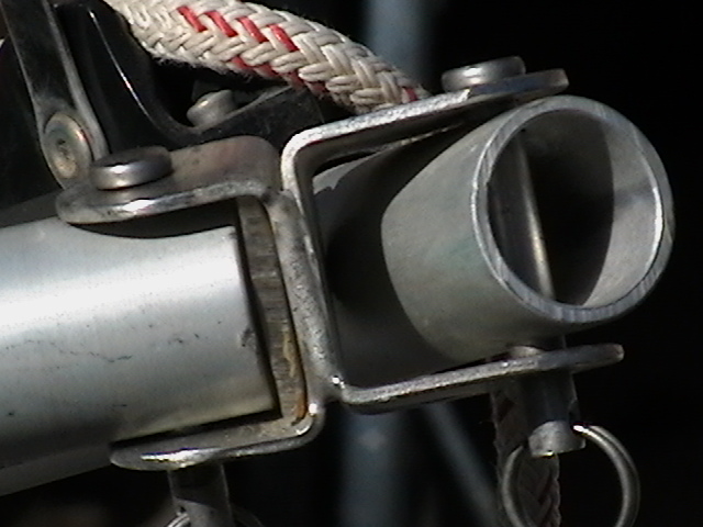

It seems to me that you are only getting half your movement because of a previous "fix". This image shows what appears to be mild steel added on inside the "U" that attaches to the crossbar. I think that this part of the connector needs to be rotating around the end of the crossbar. The mild steel is preventing this.
Did you say that you switched the connector around so that what is on the rudder arm is now on the crossbar? What if the longer "U" section was on the crossbar and pivoting cleanly around its tip? Is the mild steel preventing this switch?
Here is a picture of Airborne's.
It seems like the longer U is on the crossbar.

The connector has been modified and installed differently from what was intended. The geometry of the pins is incorrect which is why they are binding.
But the solution is to buy new connectors and install them correctly, as in the above photo from The Beachcats.

That is not a peice of mild steel. It is a plastic insert that I assume comes with the original design. The previous owner never took it apart. and the plastic peice even has a small dimple in the side of it that allows it to clip into the u-joint. I tried taking it out but then the rudders are very sloppy and the u-joints flop back and forth loosely. It's put together the way it was from the factory, it just binds up.

Whoops, ignore my previous comment, I mis-understood the photo. The problem is that the part of the connector that should be attached to the tiller arm is attached to the cross bar and vice-versa.
The connector is two brackets welded together. The shorter bracket should be attached to the tiller arm, and the longer bracket should be attached to the cross bar.

I fliped them around and the binding is gone.It has full free travel.
Yippee kaiaaay M F.
I just read the last post from Dave R and need to check for the "P".
The plastic peice was a little peice of plexiglass. I think that someone put it in there to take up some slop, but every thing was backward.
