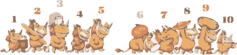

Robi,
Can you cast your opinion on this image, could you do anything with it to create a vinyl ?
Is there software out there that could remove the colour ?
I do have permission from the artist to use it <img src="http://www.catsailor.com/forums/images/graemlins/grin.gif" alt="" /> (Lynne Munsinger)
Re: Logos Sail and Hull Vendor? Price estimate? [Re: scooby_simon] #123739
11/15/07 08:56 PM
11/15/07 08:56 PM
Heh, that image would have to be vectorized and you are looking at over 10+ hours of vectorizing work in order for it to look good and the details wont get lost.
Now it would be better off printed and it must be submitted in a tif format.

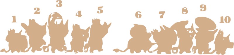

yeah, you're much better of printing that. Things like that can be vectorized but it will require a considerably larger file for the software to do it's thing well. Otherwise, like Robi said - a lot of manual work there. Here's a first sweep with some vectorizing software reducing it to 5 colors.
I do have cut/print capability and can print a full color decal of that at about 10" tall by about 42" long and contour cut around it...but again, need a higher resolution graphic. That one is good for about a 6" long print.

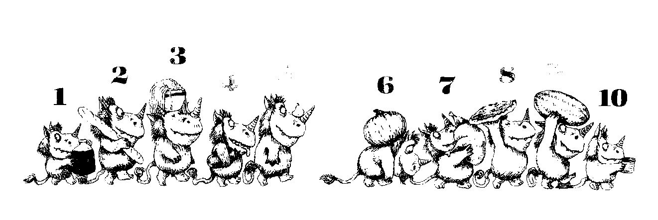

The lad mentioned removing the color. Why not decrease color depth to 2? That will leave you with a line drawing.

this?

Not really what I meant.
I used Paintshop pro at home and reduced it to 2 colors (Black and white).
A couple of the numbers disappeared but what was left was a line drawing (No fills or shading). I can attach my attempt this evening.

This is what I was talkin about.
Re: Logos Sail and Hull Vendor? Price estimate? [Re: bobcat] #123746
11/16/07 07:08 PM
11/16/07 07:08 PM
Thanks,
Robi, would it be even sensible to try and get this cut ?
Re: Logos Sail and Hull Vendor? Price estimate? [Re: scooby_simon] #123747
11/16/07 10:49 PM
11/16/07 10:49 PM
No, reason is look at the minor details, specifically the hairs. All the lines and figures involved to make out those details will cause the machine to damage the vinyl.
Also another thing that would make this image extremely hard is the weeding process which is the process of removing the vinyl that is not needed (in your case, whatever is black will actually be the vinyl, the white parts is no vinyl)
Another thing is the image still have to be vectorized, again either re-drawing or tracing. Tracing wont yield good results due to the amount of minor details and redrawing will take up a lot of time.
Simply this drawing was not designed or created with the intention of cutting it into vinyl. This is the reason why some graphics just cannot be done. Perfect example.
Your best bet is to get it printed, laminated and contour cut. The image will have to be converted into a TIF file format.
