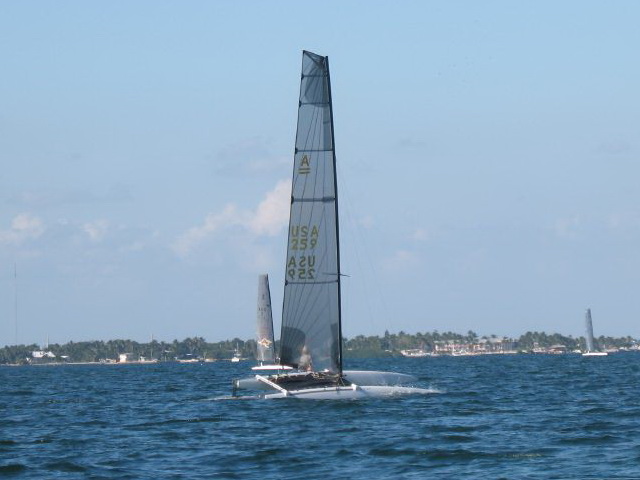

Let's start a thread about the different mains fitted on the A cats attending the Worlds.
Apart from the hard wing of Ben Hall
http://www.flickr.com/photos/58897601@N00/1953339931/in/set-72157603067880235/
I believe that Randy Smyth deserves the award for the most radical design (boomless, upwards inclined head, 6 battens)
http://www.catsailor.com/bb_files/124717-19533.jpg
After the DNF collected in the first race (due to the sail breakage, Randy's scoring improved steadily (32, 21, 13 and 12)
WOW ! take a look at all that RADICAL A-cat development. A boomless mainsail with only 6 battens !
Who else would have thought of that !

Gotta admire Ben for doing something radical and for Randy to think above the top of the mast.
I'm not sure the boomless part is a step forward, downwind you need to ease the outhaul and sheet the main, so I dont know how well a boomless main would work downwind. I would be interesting to hear from someone sailing if Randy is fast downwind or not.

When I first mentioned Randy's new main, I said it was different, not radical, think it was Tom Siders who hung that label on it.
When Randy first mentioned it to me I ran a couple of aero run's in the computer on it. The main benefit that I could see was not so much that you got more power from the sail, but that you should a fairly good chance of reducing the overall drag by a good margin and that would help your point. In addition, you'd probably be able to get the top to fall off easier in the puffs. In addition to the tip, he added a small sweeper to the base to starighten the flow there and I believe that this was a useful addition, again, not for power but to reduce drag.
Couple of computer comparison pics attached.

Erwan, the sweeper is just the flat part at the bottom/tack of the main, just straightens the stream lines (blue) and reduces the turbulence.
Rolf, yes its XFLR, and yes the 2.5D algorithm is a problem, but the example was just to see the differences due to geometry.....in the full up CFD run I did the differences are markedly smaller but still there. The L/D delta varied markedly over the wind range, just showed the 20 knot case as it high lighted the differences best.
