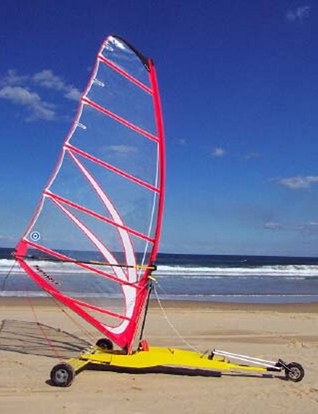

With respect to fitting a windsurfer rig to the F12 or Blade 12 this is how you do it :
Basically you keep the bottom section of the alu mast tubing and fit the front of the windsurfer boom to its top. The windsurfer mast foot is then fitted to a plate that is bolted or welded to the backside of the mainbeam. But I caution you, most windsurfer rigs are very flexible and will pump in unstable wind on a craft like a landyacht or F12. I've found this out by test sailing several mast on this vehical :
The mast show actually has a timbed rod with 40 mm diameter tucked up its inside for the first 2 meter to get the lower portion stiff enough to give is a nice behaviour in gusts. Another mast I test had a 2 mm thick wall aluminium tube hammered into the bottom but pumped like crazy still.
Also take a look at Grobs craft to see the same setup used on a sailboat.
