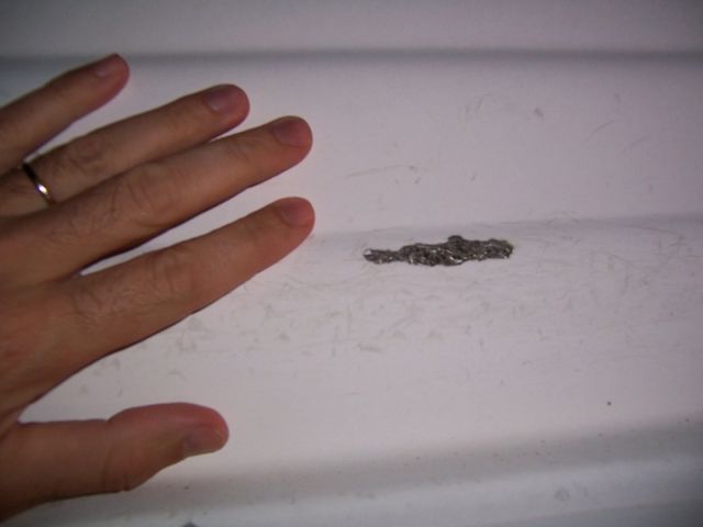

I have a spot or two on my hull where the white (gelcoat??) have cracked off. I can see fibers of the fiberglass that should be covered buy the white layer.....
So How do I begin to fix this? I would like to get back to a nice white smooth finish.... (evenif the white is not quit the same white as the rest of the boat.
Thanks

The links posted above are great. I'll just add a word of encouragement that gelcoat is very forgiving and really quite easy to work with. Don't be afraid to tackle it--take your time and have fun!

If you're not overly concerned about cosmetics, and just want to fill in the chipped gelcoat, Marine Tex is pretty good stuff. It's an inexpensive epoxy putty that is easy to apply and sands easily too. It comes in white, but it ends up as a flat white, not shiny, so it will be a visible repair.

I've found that gelcoat is no more difficult than Marine Tex for most repairs, especially just filling gouges. I like having the repair blend in with the rest of the hull rather than screaming "REPAIR!" to everyone who sees my boat. Just my .02, but I'd do the gelcoat for sure. West Marine has one that doesn't require covering with plastic to finish out, and the results are very nice.

Gelcoat is really very easy to work with. If there is a small ding I would fill it with formula 27 by evercoat it is polyester based and some people say it is hard to get polyester to adhere well to epoxy(lots of debate on this). Gelcoat is basically tinted polyseter resin so I like to work with like products. West Marine does carry a gelcoat that has wax built in so you don't need to cover it to make it cure(I think they call it finish gelcoat) ;however, I have found that shooting PVA over it helps it to cure and is easy to remove before wet-sanding. Check out www.teamseacats.com Jake has put together a great tutorial for basic repairs.

looks like the gelcoat is actually separating from the glass. Or not... maybe it is the lighting. If so, then things are going to get more complicated.

I think it's the lighting. Haven't looked at the boat all winter, but I don't remember separation. Oh well. I have the rest of the winter to research.
