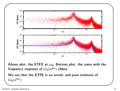

Compare it to this. Take you GPS track log and remove any smoothing (averaging) of the speeds, you are very likely to see more then 1 or 2 spikes in your speed data. There is simply no way you can accellerate from 10 knots to say 25+knots and back again in 10 seconds. Any real life system will be disturbed by such factors, many systems will be HIGHLY disturbed by such factors all the time, in that case we say the data is disturbed by noise. Compare the last situation with old AM radio's and walky-talky's; the cracking and hissing sounds making speach almost indelligiable. Modern devices you a score of mathematical smoothing and post processing technics to filter out the speach from the background noise/disturbance. And the measurement based ratings system actually so a very similar thing.
Measurement based rating systems force a smooth function (or graph) to be fitted to heavily disturbed measured data. This graph is then the best fitting for that dataset given its enforced limitations on smoothness. So yes, it may distort the pitch opf the "speach" at little but it is still a [censored] load better then the old way of trying to hear what somebody is using over the screams and clicks of the static (background noise).

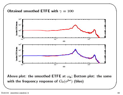

This graph below gives such a example of fitting a very simple mathetical model to a very disturbed set of measured data.
Raw data and the real underlaying system
Smoothed data and the real underlaying system
Now any rating system that is entirely based on raw statistic data will have to work with a cloud of distributed datapoints where no simple assumptions with respect to averaging can be made.

I will tell you what will happen, you will loose accuracy as you will be averaging the relative difference in fleet skill between EU and USA and deduct that from the REAL F18 designed in performance which will at least be the same or just above the EU level.
Having more data simply does not garantee higher accuracy. There is such a thing as poor and good data.
