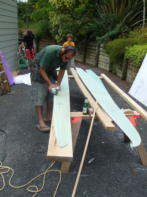

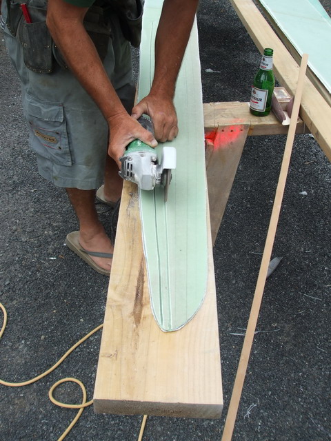

The slits in the bottom panel are so the panel can be curved into shape in the jig. After its in place and tabbed to the other panels, you fill the slits and glass over it. A grinder disk on edge was used to make the slits.

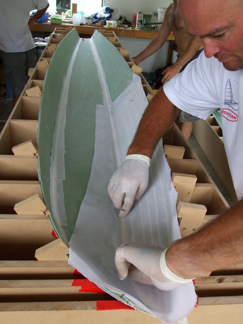

A couple of pics of the first 2 hull halves done, no bulkheads yet, just the hull panels tabbed together in the jig. We are shooting to have all 4 boats finished/launched at the same time.

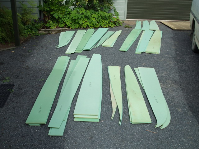

All the cores for the other 3 boats.

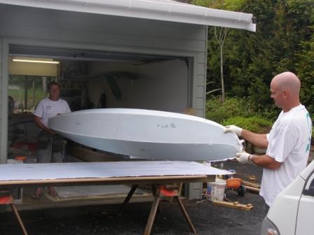

Here's a picture of the two halfs together for those interested.
