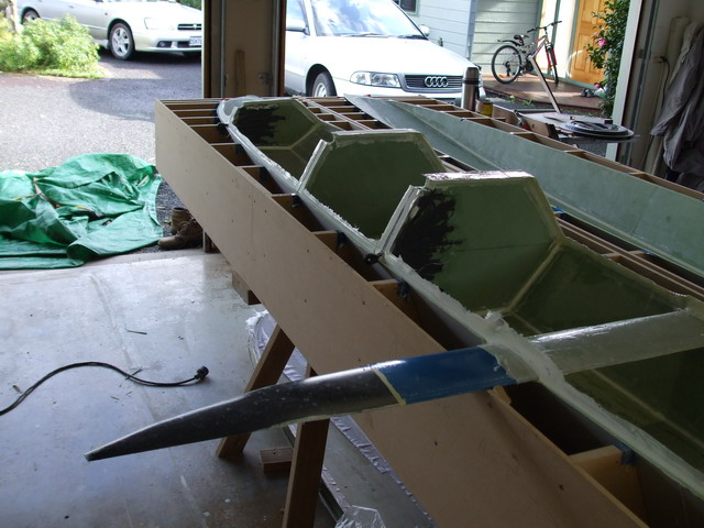

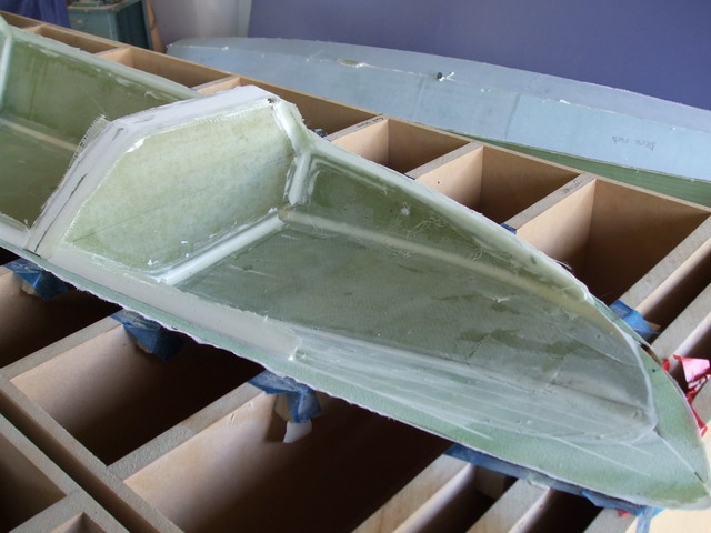

Hi all,
short update, all the hull halves for the 4 boats are finished now, a couple of boards have been made and the flanges for joining the hulls are being installed. Billy's wife wrote an article for the next Aussie Multihull mag that will be out in the next issue, with luck that will generate a bit more interest.
Jeff....why wouldn't we want to sink 420's ? <grin>
Other than that I think life has generally intruded significantly on boat building recently, but some progress has been made.
RG

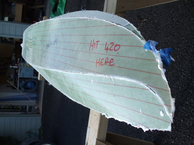

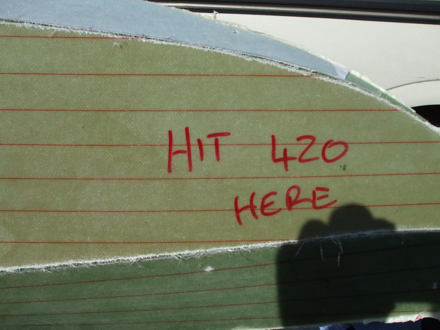

Jeff, just for you :-)
enjoy
RG

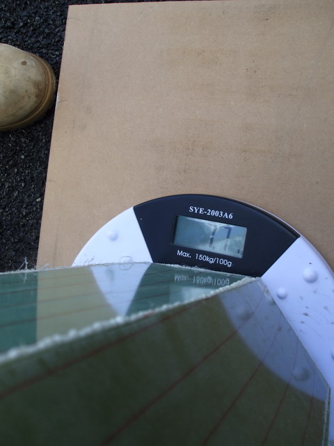

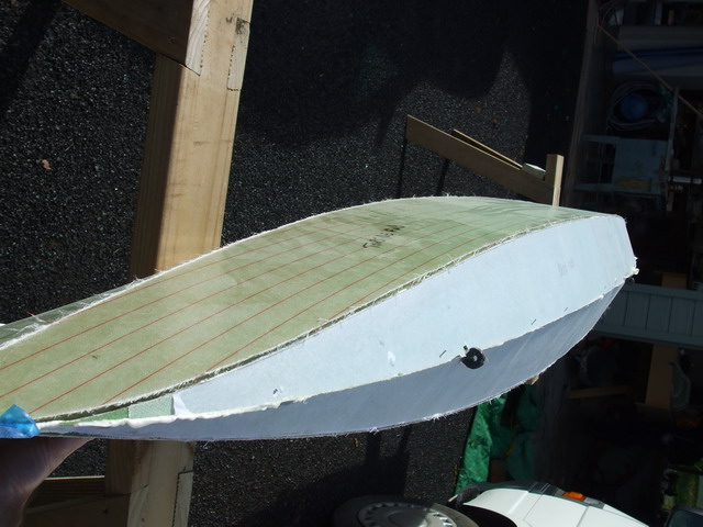

Update: see attached pics, 2 hulls closed up and ready for external tabbing, primer and paint. As shown with peel ply still on the outside, each hull weighs 7.7 kg. Expect the finished boat to be well below 50kg finished.
Enjoy the pics
RG
enjoy
RG
RG your vewy vewy naughty but I like you <img src="http://www.catsailor.com/forums/images/graemlins/grin.gif" alt="" />
Is the blade sticking out the side in the other pics to finish off survivors?
Good to see the pics

[/quote]
[/quote]
Gotta love people who think creatively <grin>
RG
