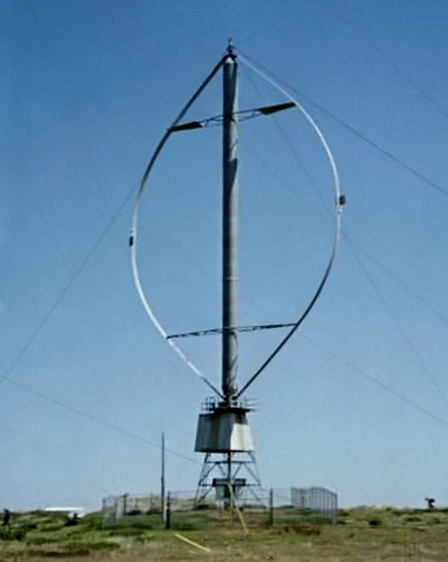

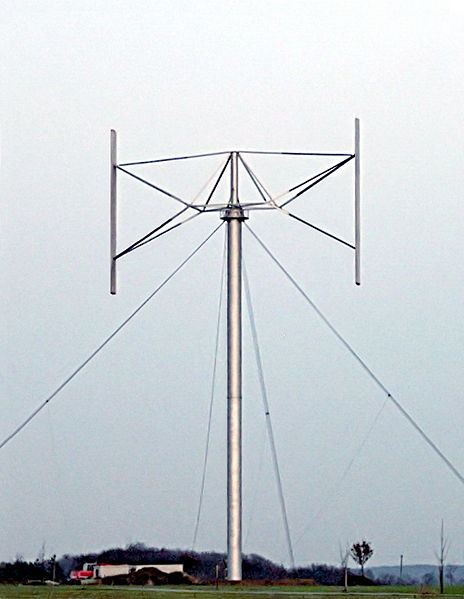

Wouter, a long long time ago ( over 30 years ) I was working with a guy who was experimenting with horizontal turbines rather than vertical. Basically he had 4 wing sections on long horizontal poles, the wings were set up so they started to tilt when over a certain speed making them less efficient and thus governing the speed. His big problem was to get them spinning in low winds to then create lift which powered them up. His reasoning was that a small wing section on a long pole generates a lot of force rather than the inefficiencies of a propellor, much easier and simpler to build as well. Anyway why has this type of turbine not developed rather than the props we know of today
Sounds alot like a Darrieus rotor [Re: waynemarlow] #131800
02/21/08 01:32 PM
02/21/08 01:32 PM
Sounds alot like a Darrieus rotor.
http://en.wikipedia.org/wiki/Darrieus_wind_turbine
The patent on it was given out in 1931, yes indeed, 1931.
Most of us know it by its curved version, as a result of the movie waterworld.
In my opinion it is a very elegant design, even magical with its vertical axis of rotation and it being totally independent of wind direction and speed. I mean how can it actually work like that ?
The reason is pretty simple but you won't figure it out for yourself that easily.
And water world was right in its usage. It is one of the very best rotor designs for a vehicle. It points straight up and works irrespectibally of the direction the vehicle is heading; it is said to even work when travelling directly into the wind ! But I've never seen any proof of the latter.
Is that the type you mean ?

Yes your top picture is similar, why when they should be really efficient are they not being developed, I think they work because of the apparant wind they generate.
As far I can fathom props should / are really inefficient
Re: Sounds alot like a Darrieus rotor [Re: waynemarlow] #131802
02/21/08 02:45 PM
02/21/08 02:45 PM
Please read the wikipedia article that was provided.
Should answer most questions you have.
The only thing I missed in it was a comparison between energy yields (efficiency) between different rotor designs. Here the Darrieus is pretty good but the standard three bladed (upwind) rotors are still more efficient.

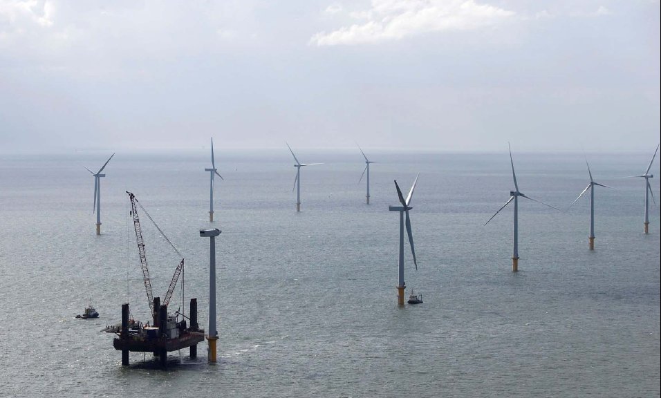

Wouter-Your research is very interesting. Are there any of those mega windmills operating now? 100 meter span is huge. I know I met a guy here in town that builds windmills and ships them all over the world though I can't remember the company's name. But having the Tennessee River on there door step makes shipping much easier.
Joanna
"Too Sharp to Touch"
Re: Sounds alot like a Darrieus rotor [Re: Joanna] #131804
02/21/08 03:32 PM
02/21/08 03:32 PM
yes. Although the smart rotor concept is still in research and/or feasibility study stage.
Here is a windpark with 104 mtr diameter rotors. Notice the scale of the tugboats !
These pictures will give an even better feel of scale, notice the two persons standing on the stabilized walkway and the dinghy at the very foot of the tower. The stabilized platform uses a setup also found in flight simulators. It's base is made up from 6 very large hydraulic actuators that are computer controlled to keep the walkway level with the doorway in the tower when there are rougher seas.
Phill, these are actually the turbines that you have seen off the coast of Zandvoort. It is the windpark off "Egmond aan Zee".
