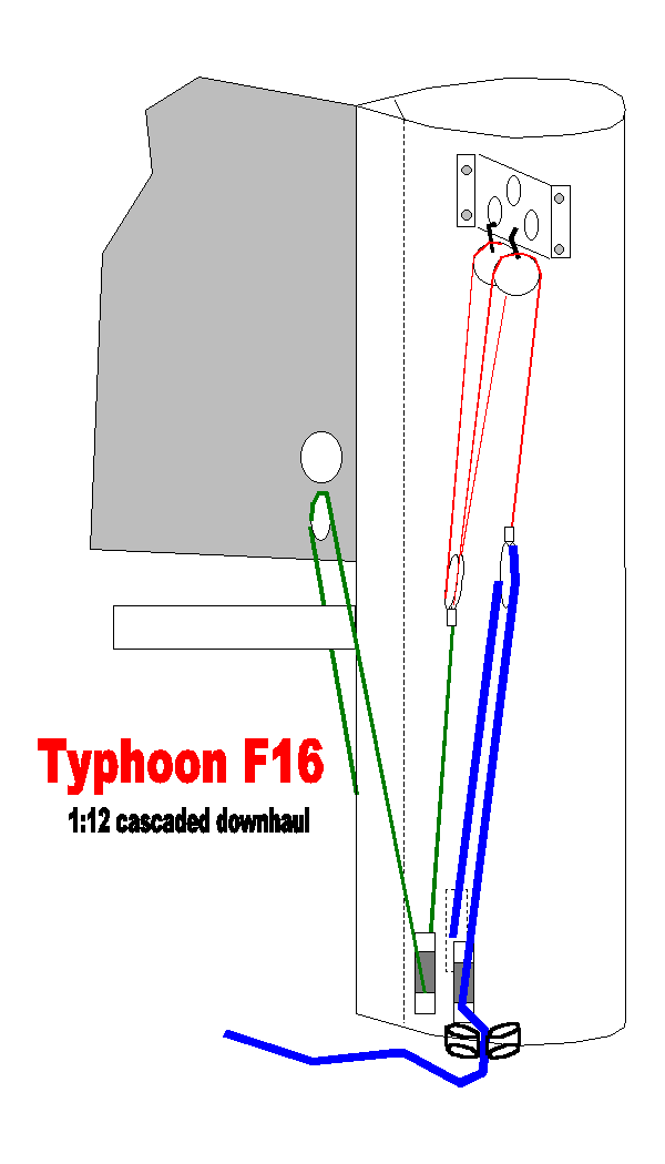

The external downhaul running under the tramp... please describe it in more detail.
Re: Review of Viper F16 [Re: GeoffS] #133420
02/26/08 10:39 PM
02/26/08 10:39 PM
Joined: Jul 2002
Posts: 539
taipanfc Offline
taipanfc  Offline
Joined: Jul 2002
Posts: 539
Same as seen on the Capricorn. Basically, rather than the downhaul cascading system going into the mast, it does through the tramp and sits underneath. Rather neat and out of the way. Don't have a pic or a link to one. Sure someone else can provide that.
Re: Review of Viper F16 [Re: GeoffS] #133421
02/26/08 10:53 PM
02/26/08 10:53 PM
Take a look at the Capricorn Owner's Manual - page 18 and 24 have pics showing where the downhual runs through the tramp.
http://www.ahpc.com.au/p_techsupport.htm
The cleats are outboard next to the front beam - red line. Under the tramp, the lines pass back and forth through microblocks to provide additional purchase.
This is a pretty good system - as mentioned, very clean and low-profile with the tails sucked up into the front beam by bungee. I have found that the line is prone to chafe where is contacts the gooseneck and have replaced that section of line three times in two years of pretty hard racing. Also, you must pay close attention to resetting the system between races or you risk having all the downhual pulled out one side or the other - there's a good bit of line in the system and in the front beam, so it might take two or three races, but you'll eventually have one of the microblocks under the tramp dead-end against the fixed cheek block.

With the Tornado style system (same as Nacra infusion and Hobie Tiger) ...
The Aussie Blade F16 is fitted with a very similar externally cascaded system as well. The VWM Blade F16's in standard setup has also a external cascaded setup but that one lays along the mast.
This setup is getting pretty common on designs. However I personally still prefer the internal system alot. Mostly because I keep my boat on the beach in all weather, salt and sand. External lines become hard and abbrasive very quickly under those conditions. And that makes downhauling very hard. The internal downhaul system does not sure from that.
Exactly, my taipan and A cat downhaul drives me crazy when i need to replace the rope internally. What should normally be a 10 minute job becomes and hour and a half job with drilling and riveting.
I have indeed opened up my mast to get to the internal downhaul system ones, but didn't spend so much effort and time on it as it made out to be here. There are several tricks to avoid drilling and rivetting or spend lots of time on it. Shouldn't take more then 20 minutes all taken together.
Basically, I unstep the mast but leave all stays attached. I lay the mast next to the boat. Then I unhook the diamond wires from the spreader arms; the diamond stays go slack. The unscrew to two retainer screws from the mast bottom and the whole mast base plate comes undone. I take it off and let it hang off the mast by the diamond wires.
I then pull the first stage line and the first stage block drops out of the mast. I untie it from the second stage line and stitch a long "helper" line to the end of the second stage line. I then pull on the third stage line (last stage that comes out of the mast) and the whole internal block system and all lines drop out of the mast. That includes the wholly internal the second stage line as that one terminates at the floating block and not at the mast bar or something. The only exception are the two blocks that are fitted to the internal bar but I glued those shackles tight so they will never come undone; I also carefully selected those blocks and shackles so it will take decades before they wear through.
Basically everything is now out of the mast ready for inspection/repair/replacement. Gettting the stuff back in is the same procedure in reverse direction.
Doing the whole job take about 15 to 20 minutes if you don't waste time yacking to interested passers-by.
Last time I did it all internal lines looked as new (1.5 years of sailing and leaving the boat out on the beach in weather and sand).
The first stage line itself (the one you are holding) can be replaced very easily without doing stuff like taking mast off the boat. Just stitch the new line to the old line and pull the setup with a little care throught the blocks and out the other end. I do this every winter because I want to wash my downhaul line clear or salt and sand that has accumulated in it over the sailing season.
But I guess you have to think systems like these through before making them and repairing them. I did when I designed and implemented this 3-stage cascading system. It is both more powerful and runs smoother then the standard AHPC internal system and more easily repaired.

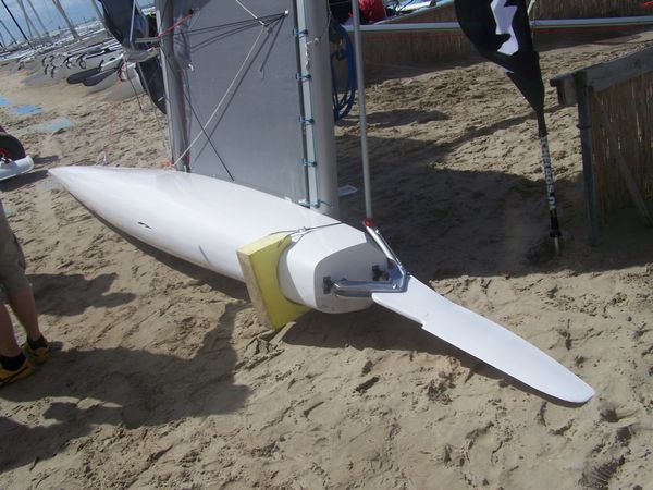

Here's a photo of the stern section, it also shows the big volume hulls and bigger section rear beam.
