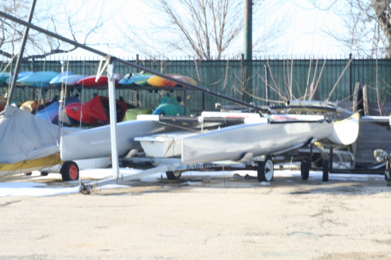

Is that the 18HT? As it happens I saw a cat today in a yard at Montrose Harbor while I was out scouting launching locations. I wasn't sure what it was, but the hulls looked a bit like yours. I took a few photos, though without realizing my camera was set on shutter priority - so they were a bit blurred. Here's the best of them. Could this be an HT?

Yes, that is an HT, stock BIM Jav2 2002, couple of guys from Chicago own it.
Its been painted grey.

Thanks for that Bill. Now I've just gotta figure out how they get it into the water there.
