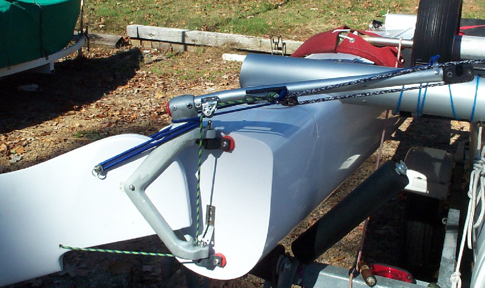

EASY!
Need a little closer up to see what your pintles look like to see whether you can run a line through them. Basicly, look at this pic. This has a 2:1 pull down on it too which makes it look a little complicated... but it is nice. This shows the line running through the rudder casting but you can run it through the pintle if it is V-shaped and open like a lot of them are.

here is a pic. you can see the line coming out of the rear beam. this goes to the block which is the 2:1 for the pull down.
