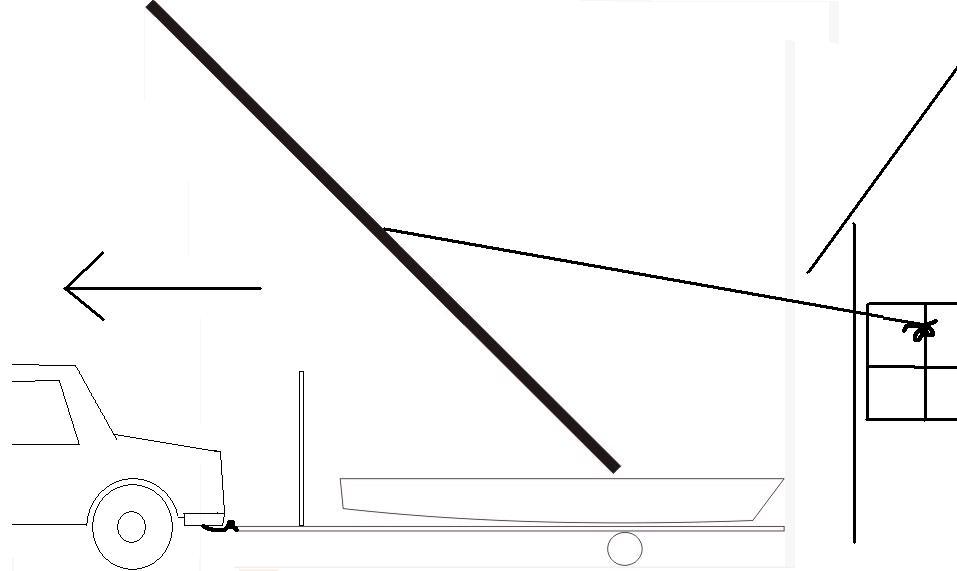

Here are some ideas that have been kicked around. mast raising
I remember, I came up with a brilliant one:
