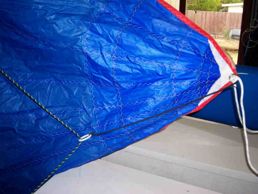

From this Thread
And possibly this ONE
I edited to resize the picture.

cheers thats it .
that photo is BIG !!, thought my browser settings were fecked as you have to scroll soo far to read now .

Looks awesome!
Which works best, bungie or regular line?
what is the bungie in the pic tied to? It doesnt look like it is in the clew/gromet. Is it tied to the bitter end of the spin sheet (that we cant see?)

Bungie is probably the way to go. I think some stretch at times is useful.
One of the features of the system is that it sucks the extra spin sheet off your tramp and into the bag. I personally did not have to lengthen my sheets. I believe that it also pulls some of the extra spin halyard (when using the single line system) off the tramp while the spin is up.
