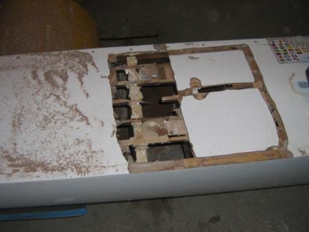

06/29/08 06:35 AM
06/29/08 06:35 AM
Joined: Apr 2007
Posts: 432
Simon C Offline OP
Simon C  Offline OP
Joined: Apr 2007
Posts: 432
This is mid way through exploratory surgery. (Thanks Trevor for showing me the way with that first router plunge)
Looks like the cause of my problems is a very dodgy repair!

Simon C Offline OP
Simon C  Offline OP
Joined: Apr 2007
Posts: 432
Notice the join in the stringers.... no support and bugger all glue... Also, its a bit hard to see but the deck support was put in with bog.... no epoxy let alone tape.
