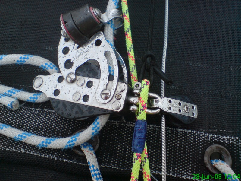

Here's how the line and shockcord attach to the block
