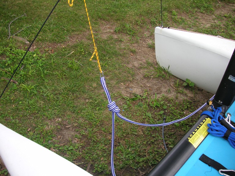

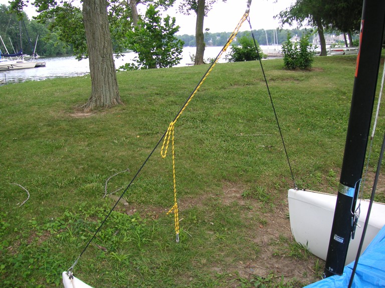

I've think I've come up with a fairly easy solution, which incorporates Mary's hand loop and my three-point foot loop idea. I've tried it (in calm conditions), and it works very well, with almost no upper body strength required. Hopefully it will work just as well in windy, wavy and panicky conditions.

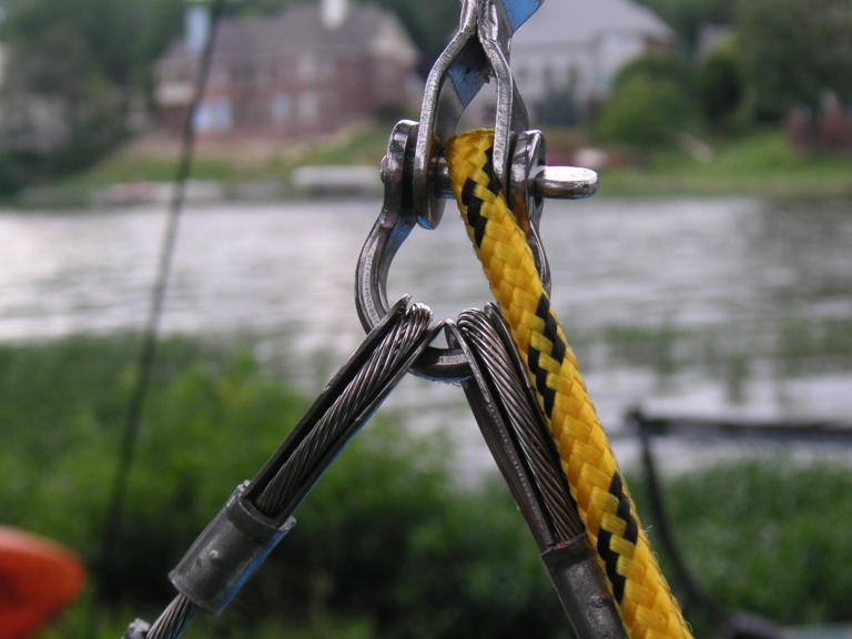

Start with a rope about as long as a lower bridle wire, tied at the bridle shackle, with a carbiner at the other end. Then tie a knot forming a loop onto the bridle wire, about half way down.
I tied it on the bolt to prevent chafing the rope.

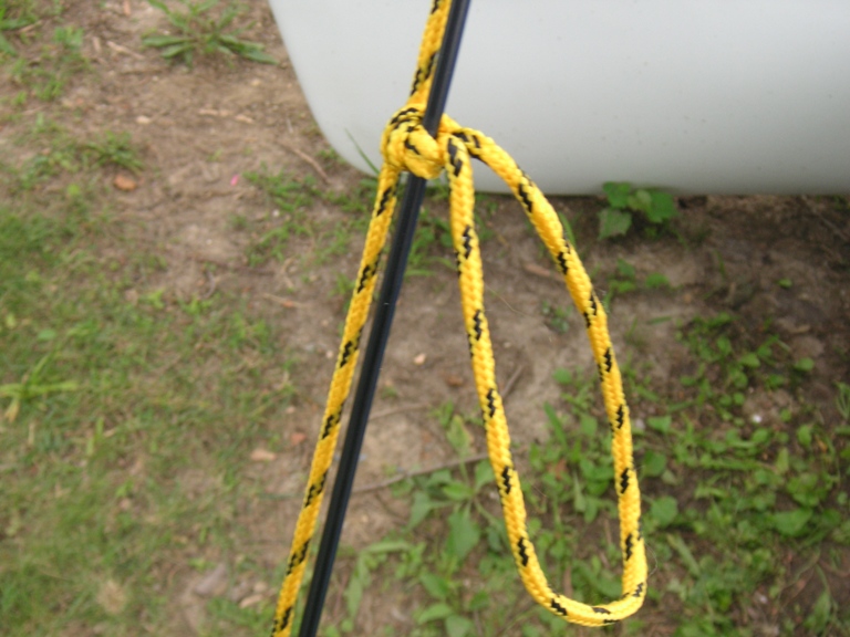

A simple over-hand knot forms the hand loop.
After righting the Wave, tie a knot in the righting line to form a loop near the middle, and clip the carbiner to it.
Then you can step onto the righting line (it won't move now) and hold onto the hand loop, and lift yourself up onto the hull or crossbar.
When the boarding line is not needed, you can clip the carbiner to the bridle wire or bungee it to the bow eye. I used bright line for contrast, but black rope would be inconspicuous.
It works so well, I can now see using the Wave as a swim platform on the no-wind days.

I don't quite get it. What is that loop for on the bridle?
Re: Re-boarding a Wave after a capsize [Re: Mary] #149081
07/26/08 06:07 PM
07/26/08 06:07 PM
Posts: 342
IndyWave Offline OP
IndyWave  Offline OP
Posts: 342
That's your hand-hold loop, to give you something else to grab and pull up with, besides the mast or crossbar. I guess you could just grab the wire, but the loop keeps the lateral force off the eye-strap bolts (plus I wanted to shorten the line a bit).
After Wednesday night racing, I just stopped in the middle of the lake, jumped in the water and played around with the ropes till I found a combination that worked.

Exactly, Matt. I have never seen a boat easier to right. In heavy air, I don't even need a righting line.
Pete, I think you are on to something. If I am visualizing correctly, why not use bungee cord in a hollow line, i.e., for attaching yourself to the boat in the Worrell, Tybee, or Great Texas? Couldn't put in knots, however.
But, either way, it gives you a place to put your foot and hoist yourself up on the boat between the bows.
