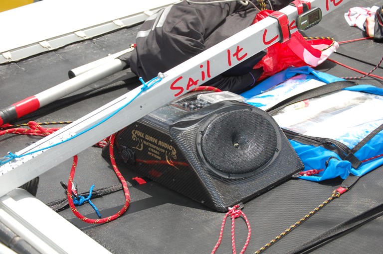

Full Wave Audio: Got a waterproof Ipod holder, Ipod controls, and 12v battery good enough for (rocking loud and great quality) tunes for an entire Tybee 500 leg and then some.

ThaT looks awesome.. where did you get it? what did it cost? when i google that i get parts, not an enire system
http://www.watercraftinnovations.com/index.cfm
