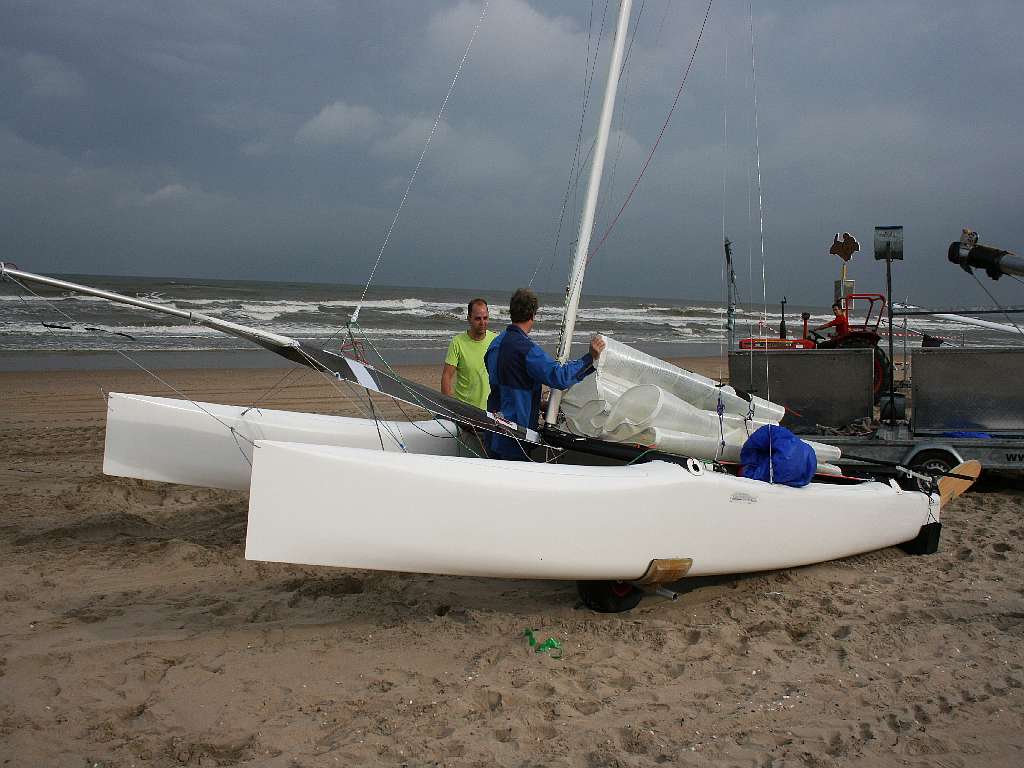

Simon,
The White Formula 20, I've only seen this boat once and was interested in the boards that go diagonally through the hull just in front of the side stays. For others who have not seen this I took a pic and you can see the slot with some tape over it to keep the sand out while rigging.
As this boat also has normal C/Bs how do you treat the extra set of boards on the White F20 in the SCHRS rating system?

Currently we do not rate them; it is on the list of "things to evaluate" at present.
I was talking to Rob White about them a few weeks ago and they do provide an advantage in the big stuff down hill.
Suffice to say the management group are aware and we'll be talking about this once we start on any updates for 2009.

Simon,
SCHRS does use C/Bs specs when rating a craft do they not?
Currently would you add the specs of the 2nd set of boards or just ignore them altogether?
Just curious.

we do currently rate plate aspect ratio; we do not rate the number of plates.
THese curved plates are smaller and have a lower aspect ratio than the "traditional" daggers and so are not rated. As I said above we are investigating.
