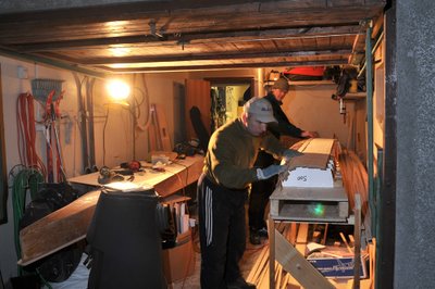

First hull half is now mostly planked. Putting the planks in place is satisfying work, if demanding at times. I suppose it will become routine when we get to the last hull.. Updates are in the blog.
BTW: For those who dont know, I am the stern guy with a green shirt and a caps on. Frode is the tall guy with the woolie.

Some have called us nuts, so we had to find a way to block out the negative waves. The solution was obvious:
Re: Blade building project.. [Re: Rolf_Nilsen] #160493
11/15/08 06:37 PM
11/15/08 06:37 PM
Rolf,
That picture is proper funny.
Keep up the good work

We have a good time in the workshop, when it is possible to talk over the noise from powertools that is.

Just in from Interpol:
Large quantity of carbon stolen from warehouse.
Suspects wore tinfoil hats and where last seen driving in an easterly direction. wink

Omar, welcome aboard, was that you in the foil hat or Frode?

Thanks Timbo for kind words and support during difficult time of messing up! I must admit it was me wearing that foil hat, next to Rolf. Good to be amongst friends here by the way;)
