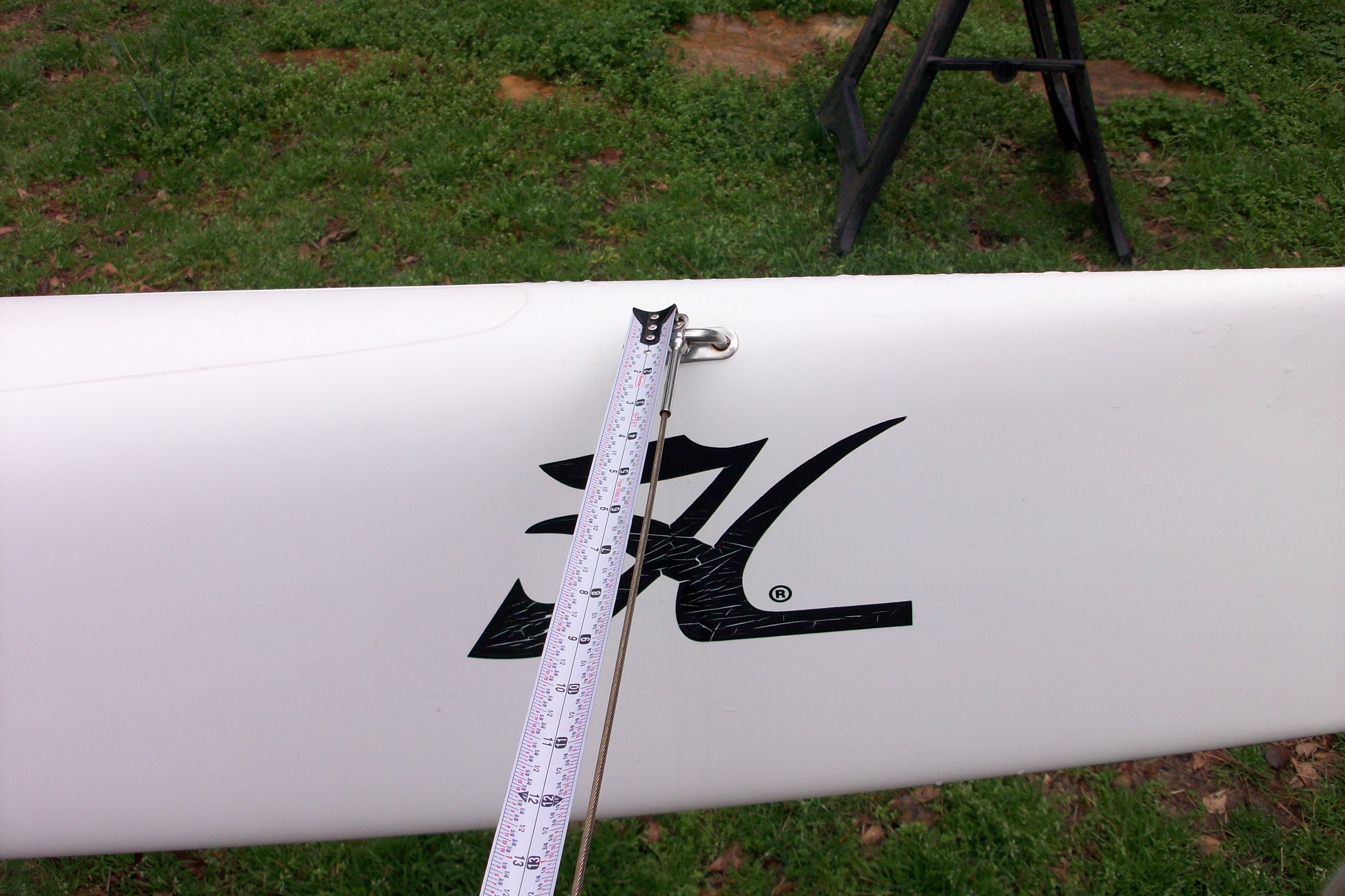

I can make my own but since my wires all have a "Marine Eye Terminal" on one end I have them professional made. But having said that, I carry swages, extra new wire rope and the crimping tools in my spare parts as I've had to make a new shroud for a friend on Saturday night on several occations when they needed one and no dealers were close or open (imagine that on a Sat night).
Notes:
1) Always replace BOTH shrouds at the same time ... if one has failed the other is not far behind. (I always carry a new spare SET, once they come off the boat to be replaced, they do not ever go back on!!!! I immediately order a new set and place them in the sail box)
2) Save the old wires as there are many "non-critical" uses ... I've made awnings for the backporch ... staywires for various projects at the Yacht Club ... etc
And yah, I got that wrong on the 7X19 wire discription ... the first number is the number of wire bundles and the second number is the number of individual wires/strands in each bundle. Thanks Matt (I think my grey hairs are effecting my memory ....)

Re: Standing Rigging Questions [Re: F-18 5150] #174012
04/06/09 04:11 PM
04/06/09 04:11 PM
Posts: 3,969
brucat Offline
brucat  Offline
Posts: 3,969
I tried being cheap ONCE. Made my own at WM, using their parts and tools. Failed the first day on the water.
Thankfully, it was "just" the trapeze wires, not the stays. Really upset the crew when she went for a swim though. I still can't believe that she held onto the boat for that long... smile
