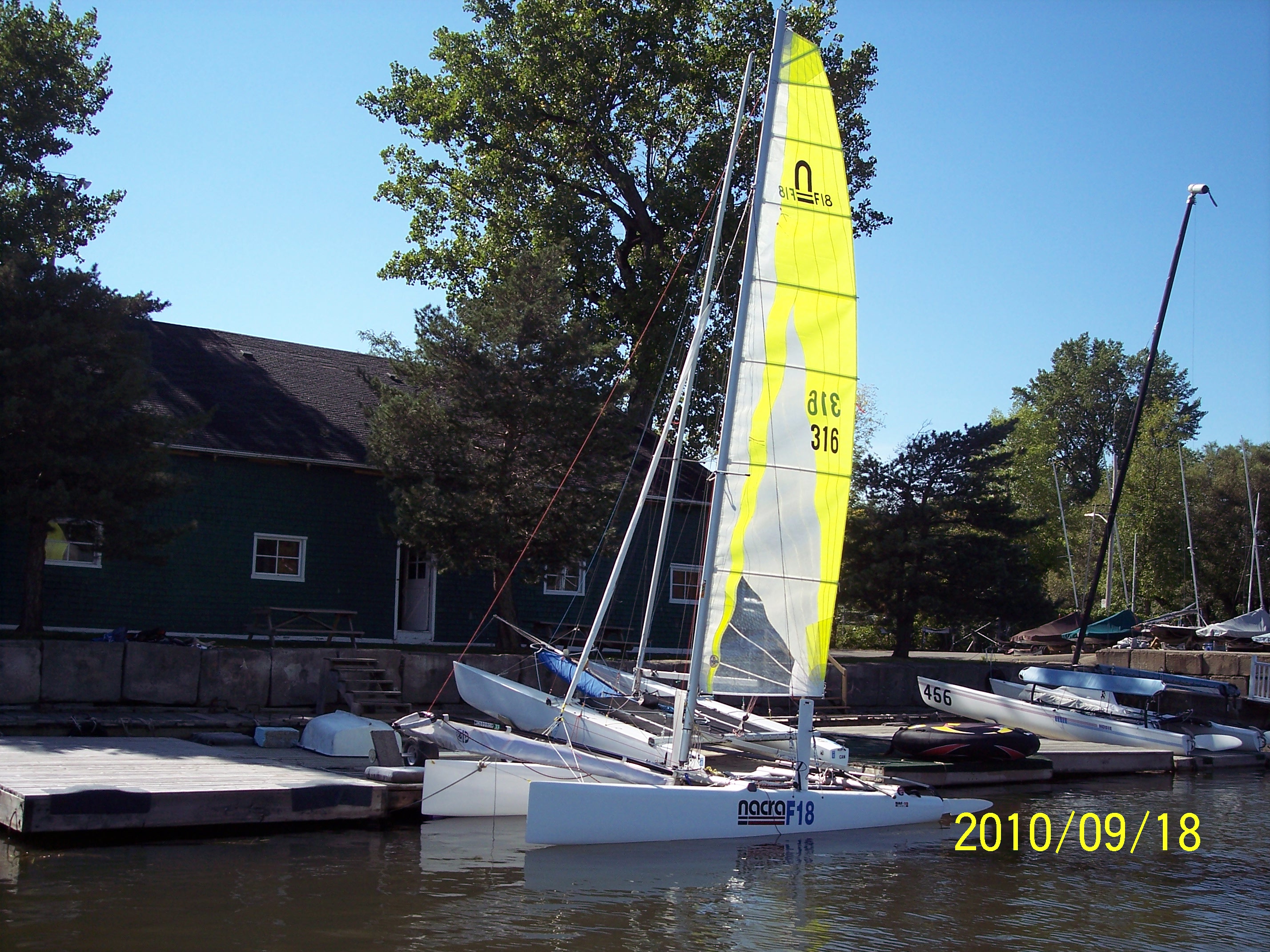

Always used a rule to keep the main sheeted tight, centered,
when flying the spin on my Nacra F-18. I've also kept the
rotation tight.
My buddy with a Tornado, is telling me that he rotates his, mast, and allows for some main in 15-20 knot (balancing the
pull from the spin).
I think he's crazy, One of us is wrong
Your Thoughts
