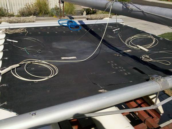

So it looks like these are the wires i have, im going to take a wild guess and assume im missing some because i am reading through the pdf of the owners manual and not seeing any turnbuckles with the wires i have.

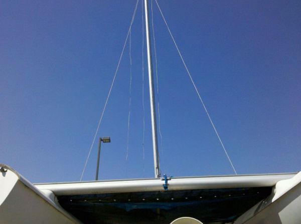

so after setting up the mast it looks like there is no place for a boom. So now it looks like i have a boomless prindle 16.Is not having a solid boom a huge disadvantage, or is it not that big of a deal if your just sailing lakes?
Also after setting up the mast and securing all of the wires it seems like the mast is somewhat loose the the moves around a bit. I was wondering if there was any way of tightening it down? There are no turnbuckles on the wires so i cant figure out how to tighten the wires down. Any ideas for that?

slide the white covers up that are at the bottom of the shrouds. You should find the shrouds are attached to fittings that have holes so you can move the shroud down to tighten the rig. You should look for a P-16 Assembly Manual on line and read it.
Are you saying there is no boom with the boat?

These are called "chain plates" and should have a series of holes in them to adjust the shroud length where it connects to the hull. These are normally left very loose so you can step the mast and pin the forestay without any resistance. Once stepped, someone usually hangs off a trapeze line to preload the rig and then a second person pins the shrouds as low on the chainplate as possible. Adjust them side to side to get them mostly even while tight. We tighten them so the rig doesn't flop around in light air (causing a slight loss of performance and adding premature wear on things)...but when sailing in any kind of breeze, the leeward shroud will always be loose. Tension isn't super critical.

Moved the rubber covers, and found the chain plates, and tightened it another notch so the mastdid dn't move around too much when i walked on it.
I now discovered i have a serious problem. I have no boom, it wasn't rolled up with the sail or anywhere on the boat. I need some serious help finding one, i wanna get this boat in the water! If anyone knows where to look or where i can get one let me know!
Recap: The boat is a 1978 Prindle 16, and I need the boom!
will the boom for a P18-2/19 work on the 16?

I have a Prindle "Escape" which is the 16 footer's rig, on the 18' hulls, and it is boomless.
Look at the aft, bottom edge (the clew) of the mainsail, see if there is a metal plate about 2" wide by 18" long, with about 6 holes in it.
If there is, you have a boomless rig, so you simply shackle the blocks directly to one of the holes in the clew plate. I didn't like the hassel of using a shackle to attach the blocks so I bought a stainless steel 4" carabiner at Home Depot for about $5, put the top main blocks to it, then clip it into the clew holes. It works great and I never have to unscrew the shackle when I'm done sailing.
