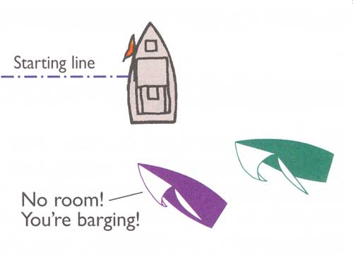

Different application of the word overlap.
Stealing images from the web.
Here Leeward is warning windward off in time and by sailing close-hauled is demonstrating the intent to not allow windward in.
Here RED allowed Green to get to position 2. Not necessarily overlapped with R/C in our defined sense of overlap but Green doesn't have a legal out.

so if Green at position 2 has no way to keep clear without hitting the starting boat, Red position 2 has to give way, correct?
If Red at position 1 had luffed harder (pointing right at starboard corner of starting boat) she could have possibly peeled Green off of the starting area? wait... it says Green had the overlap on Red at position 1
This diagram doesn't illustrate barging. It shows a case where the signal boat is not a mark (the mark is the buoy to the left). Here, the boat is an obstruction and inside boats are entitled to room. Note that this is a very unusual exception -- I have never seen a starting line set this way.
I hope that helps,
Eric
I hope that helps,
Eric
Thank you. I thought it was just me.

Yup, that's my bad. I liked the picture and didn't take the time to understand what they were demonstrating.
My apologies for confusing the issue.
I hope that helps,
Eric
I'm still struggling with "shutting the door" and "let them in". In my mind if I'm on a perfect close hauled drift to the boat I've shut the door ages ago but I can also see where W could argue I (L) let them in. The terms "let them in" and "shut the door" just seem way to open to interpretation. As a judge what to you expect to hear when these two arguments are being made. I know you've said once W is pinned by the boat it's game over W wins. I'm trying to avoid a he said she said and if I have to go to the room I want to kill it!
Yeah, I was over here going "wubudu, what?" with regards to that diagram. I would say that if the orange boat was the starting boat the the starting end of the line, the red boats have established intent and direction to leave no room at the orange boat, the green boats would need to avoid both reds and the start boat.
That diagram seems to indicate that the flag is the right end of the starting line and that orange boat happens to be some race committee just sitting there (which I have seen before...usually in sloppy beer can races where one of the mark boats loosely tie up to the committee boat.
Which does beg an interesting question. If the sailing instructions don't indicate how to treat this boat that is moored up to the official starting boat (as an extension of that boat or whatever), how do you treat it?
