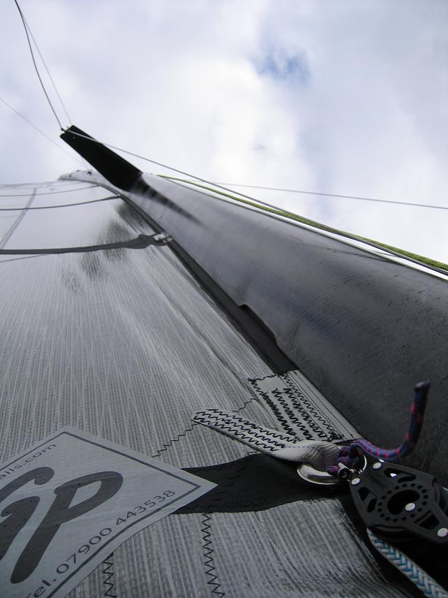

Micro cheek block is still there; the wire block (as you guess) is just tied to it; I wanted a larger dia block as at times the rope was rubbing on the gooseneck when I had lots of DH on.
Not sure who made the red rope; it's just what the chandler had at the time; I THINK it's 5mm; this setup is very efficient, I never really need to pull it hard; it just comes in when needed and because it's a cascade with fairly big blocks it runs out very well too.
The red ball, is, as you guess the termination of the line that goes thru the block on the sail.
I have a bit of D12 with the ball on spliced onto the forward block; the D12 that goes thru the block on the sail has a spliced loop just big enough to get the ball thru once pulled snug thru the block on the sail.

I think it's a 28mm Harken carbo, not sure....
Bit of Spectra line goes thru the sail and back a few times and another block on the other side; not very high tec but it works!
Shed loads of downhaul on in that pic, all with one hand and not working very hard!
