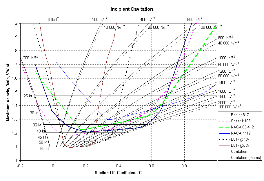

...Eppler 817 and Speer's foil shape H105 are PROBABLY best for hydrofoil sailing: These are low rise, low bucket shapes that should not ventilate readily at our speeds. Caveats: Supercavitating foils and/or air injection are for high-powered motor-driven vessels only. Sharp entry symmetrical foils like the NACA0012 series ventilate readily. I know this for a fact!...
FYI, here are the cavitation diagrams for the E817 and H105 plus a NACA 6-series section. These data are not found on the NASG site.
Ventilation, of course, is a different animal. You need to have separated flow to cause ventilation, so that may be a good place to look. I don't know why the NACA 0012 would be particularly ventilation-prone - I'd expect it to be more resistant. But maybe there were some details of the actual foil configuration that caused the flow to separate.

Thanks Tom,
Could you please add a Clark-Y shape to that interesting figure? My original NACA 0012 aluminum struts would ventilate badly when presented at high speed at any angle more than a few degrees to the water: These Aluminum struts were probably not really NACA 0012 because they had been extruded too thin, and had very sharp leading edges.
