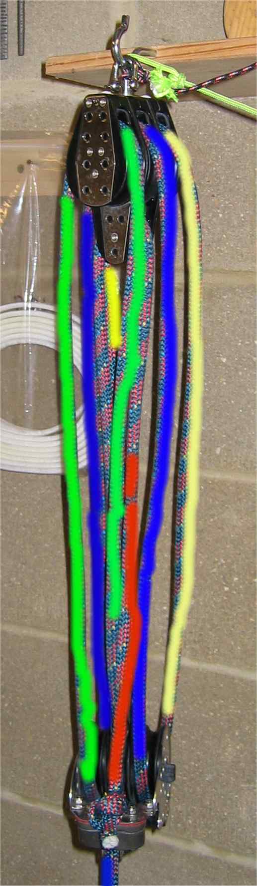

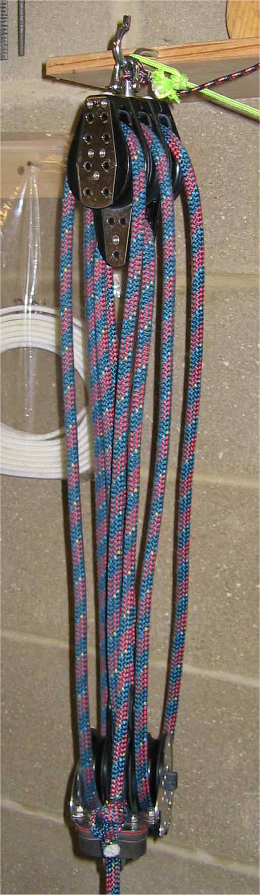

Mike,
Looks fairly similar to mine, I have just rigged it so that the top and bottom blocks (when under some tension) are running aprox 90 degrees apart
I also have all the 'outside' turns before the inside turns and then finally to the top of the cleat to tie off :

Mike,
Also, I have tried here to colour in the loops as they go around the system :
Hope this helps
Red / original colour in the inside loop
Here :
35569-mainsheet 2.jpg (24 downloads)
