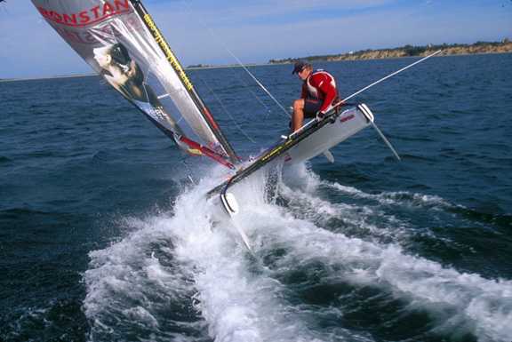

Also see attached cool pic of Gashby's Nosedive

39157-Ashby Nosedive.jpg (126 downloads)
Re: Opinions wanted on Auscat mk3 [Re: Tornado_ALIVE] #38894
10/12/04 04:59 AM
10/12/04 04:59 AM
I assume that is a staged pic as it does not look very windy judging by the sea state :

Thanks for the input! and the pic, love it!
