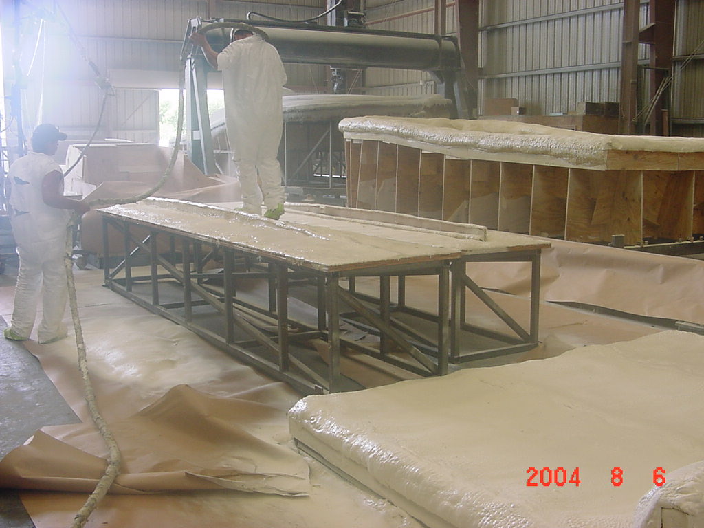

Some pictures of the building of the hull moulds are shown below. Dated : early oktober.
Foaming the bunks that will be 3D printed into the plugs.

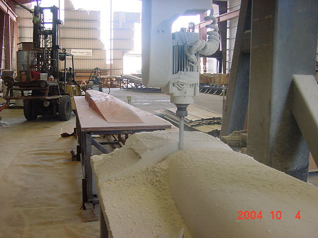

The computer controlled 3D cutter is transfering the computer model of the hullshape to the foam.
Note the storm damage to the wall/door in the back.

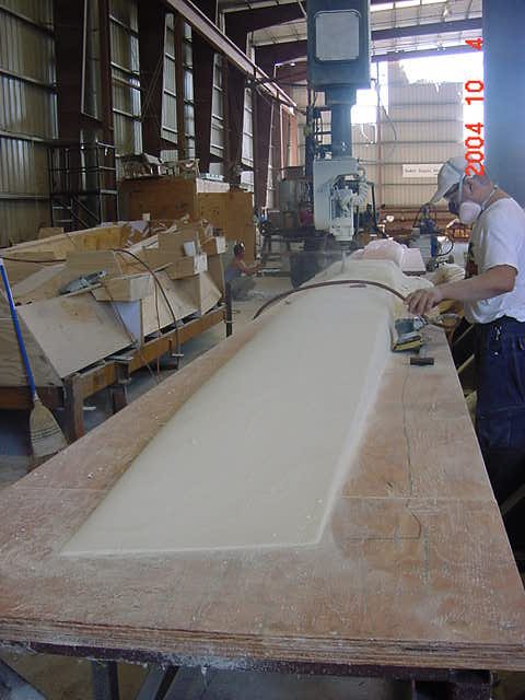

Here the worker is fairing the foam plug that has just been cut.

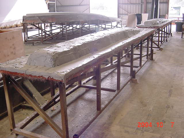

Of course they are only halve way yet as now the time has come to make the female mould using this reinforced foam plug. The female mould will later be used to produce the hulls. In the picture you can see an Epoxy compound being added to the bunks containing the plug to make up the body of the female mould.
And then we we see the end result of adding the Epoxy compound. The outside is still rough but the inside is smooth and true to the computer stored hullshape.

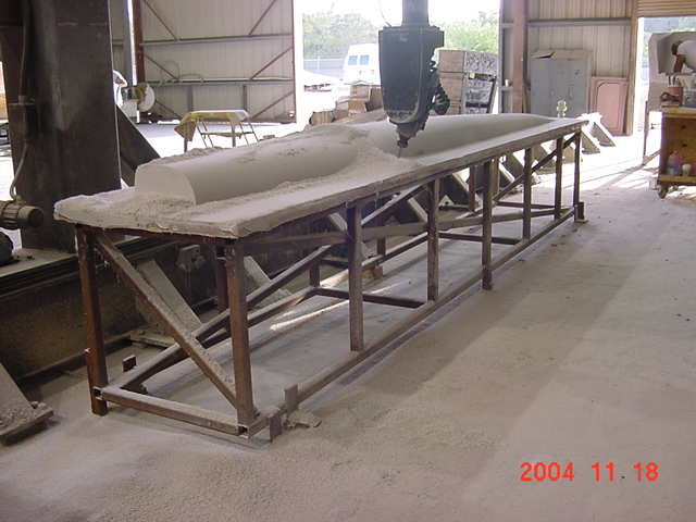

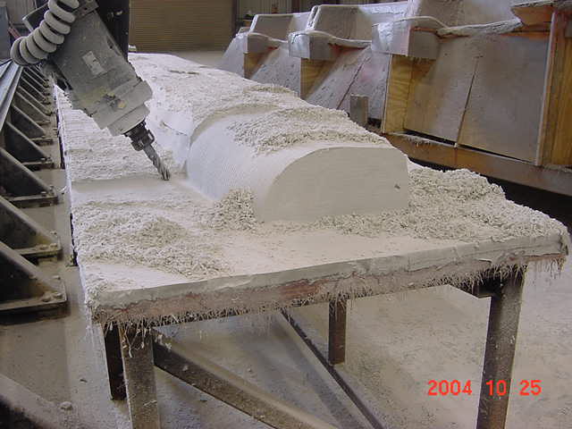

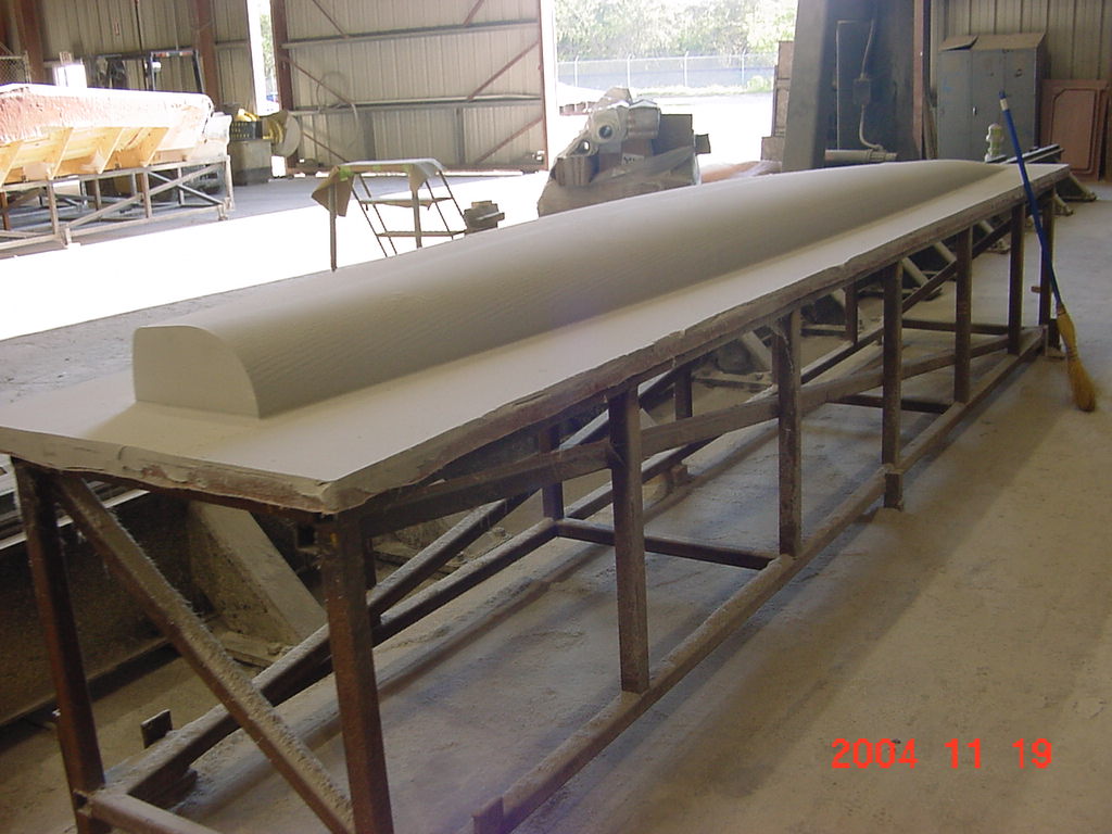

I found some more pictures of the Blade F16 mould being made :
I think I actually misunderstood what was being machine in the earlier post. I thought the brown shape was the plug and the first epoxy layer would make the mould, However it seems that the first post only showed the first stages in making the plug. So the plug is made from an inner core of foam that was 3D machined after which the foam was covered with a machinable expoy compound that would later become the outer shell of the plug. This epoxy layer is then also 3D machined into the final plug shape from which the mould will be taken.
The pictures in this post show the shell of the plug being machined. The end result is the final shape of the Blade F16 hull. This will be later mirror into a female mould if I uderstand it correctly this time.
So here goes :
FIRST PASS OF THE FINAL MACHINING OF THE PLUG.
THE FINAL PASS OF FINISH MACHINING
HULL PLUG FINISHED MACHINING
