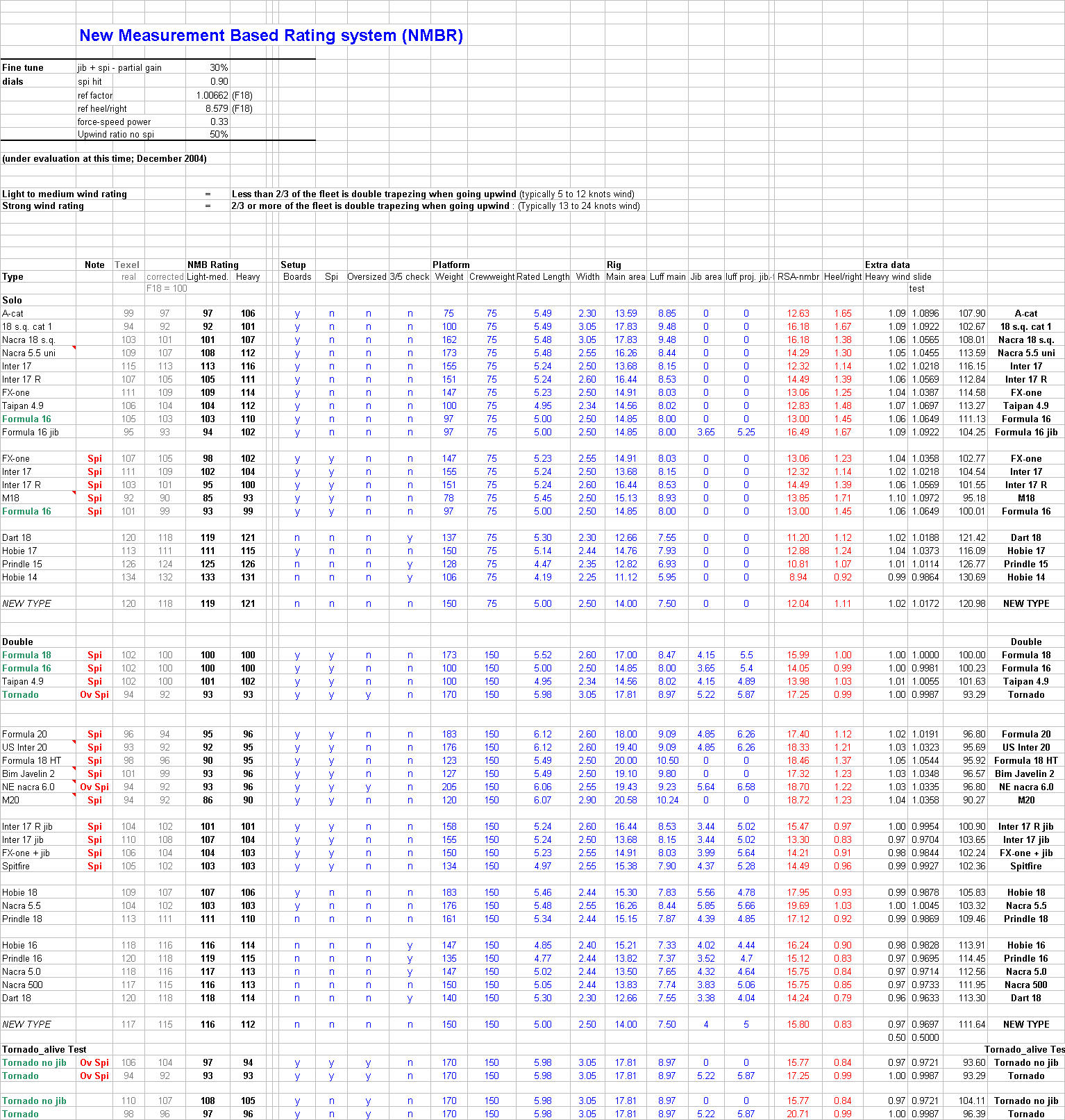

Quickly spotted one slight error, the weigh od the Inter 17 is 161 with the Spi rigged (and it makes a difference of one point on rating)
Also, I dont really think an Inter 17R(spi) is quicker than an F18 in light and the same in heavy.
But it is a start
Good work
I'm think that may actually be acurate...or close to it. The I17R carries less crew weight and points higher.
But it is a start
Good work
But also less righting moment and less pairs of hands

-1- I used the Texel core so all weights are excluding the spi gear, take a look at the F18, F20, F16 weights as well It is something I want to take out of the system as well as stated in the "Potential other mods" post, but I haven't done it yet. You can pretty much 1 point to all spi boat ratings if you use the weights including spi gear and then subtract 1 point because I will lower the spi hit to compensate. End result ? Zilch. That is one reason why I haven't implemented it yet. I'm waiting on some feedback from others.
-2- I-17R, this is an identified problem point, see the post publicizing the numbers. I'm hoping that US data and Mark Schneider can help me here. I don't have good I-17R with spi data. There is one thing to say for the NMBR rating for the I17R. This boat has almost the same mainsail and mast as the F18's on a lighter platform with less crewweight and a considerable spi. If the fundamental Texel formula is right (Not entirely sure here see post) than the I-17R should be faster in light air ! However I think NMBR makes it too much faster. I feel the cause for this is found in the Texel rating formula itself. Hence my suggestion to do a new regression on the data. In summary; we are working on it.
Also please correct the wrong width for the I-17R ; the sheet says 2.60 mtr. but it should be 2.50 mtr I believe.
>But it is a start,
I would say look at the other things, these seem to work pretty well. Of course it is a bit much to ask to get it right the first time. Some tweaking is required.

I(F)17R should be 2.5 wide (same as I17)

Hey Jake,
You can help me here. (either via the forum or in private)
I don't have much data on these singlehanders and I'll need that in order to tweak the single handers. You as a F18 sailors may help us out here.
How often have you sailed against these singlehanders and how did they compare to your F18 ?
I'm particulary interested in the I-17R as that is such a clear example and I can cross reference it with I-17 data. These are great setups; Identical setups with only a small of differences. Makes for great tweak keys.

How about a NMB rating for the SC20 TR with spi of
Light weather 88
heavy weather 92
SC20 TR no spi :
light 91
heavy 96
Compare to US I-20
Light 92
heavy 95
Seems a whole lot better doesn't it ?
I used the following specs (please give me the correct one if they are wrong)
weight 200 kg (441 lbs)
length 6.10 mtr (20 foot)
width 3 mtr (10 foot)
Mast 11.5 mtr (38 feet)
Mainsail 22 sq. mtr. (236 sq. ft.)
Jib 6 sq. mtr. (65 sq. ft.)
And I only needed 60 seconds to acquire a rating and that included looking up estimates of the specs via internet
Is that satisfactory ?

The provisional NMBR sheet can now be viewed here [Re: Wouter] #41273
12/17/04 09:06 PM
12/17/04 09:06 PM
Wouter Offline OP
Wouter  Offline OP

Hey Wout,
The SC20 is 12' wide, but i'm not sure about the wt and sa. What does the change in beam do to the #?

Here is the rating correction for the 12 foot wide SC20 over the earlier presented 10 feet wide numbers
New specs
width 3.66 mtr (12 foot) (This is some mightly wide boat)
Mainsail 22 sq. mtr. (236 sq. ft.) luff being 11 mtr
Jib 6 sq. mtr. (65 sq. ft.) luff being 5.5 mtr.
+ spi
New ratings SC20 at 3.66 mtr width
Light weather 88
heavy weather 89
Compare this to :
SC20 at 3.05 mtr width
Light weather 88
heavy weather 92
And the US I-20
Light 92
heavy 95
If we take the spi off the SC20 than :
Light 91
heavy 93
I think this reflects the (scarce) real life data well. At least heaps better then PN of 64.1 vs that of 59.2 to the US I-20
Notice how the new width didn't change any off the light weather ratings (No trapezing group); only the strong wind ratings (Trapezing group).
Again we needed only a few seconds to get the new numbers.
Also interesting is to compare the "sc20 at 12 feet width" numbers tot the ones of the M20
M20
Light 86
heavy 90
So the M20 is expected to be 2 points faster in the light stuff and a fraction slower (1 point) in the heavy stuff.
The M20 has a 4 point rating swing from light to strong and the SC20 only 1 point. This all due to the ratio between rig and width. The Hobie 16 (L = 116 ; H = 114) of course has a opposite swing (getting faster) of 2 points. So the difference between the M20 and the H16 reduces from 30 points to 24 points when the wind conditions transitions from no trapezing conditions (light winds) to Trapezing conditions (heavy winds). The difference between the SC20 and the H16 only swings from 28 points to 25 points. To go one further US I-20 (L92-H95) vs H16 : difference goes from 24 points to 19 points. However the difference between the H16 and a nacra 5.0 remains about the same (0 point differnce to 1 point difference). Both of these speed up equally due to changing wind conditions.
Isn't this reflecting what we see on the race course ?
