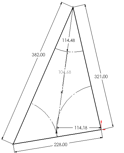

I'm trying to add 3 patches to my spinnaker for half pole snuffing system for N6.0. I was trying to use the formula from http://www.guckinc.com/spinnaker_patches.htm but it does not work for me. When I divide luff length by 4 it comes up to be 95.5 inches but spinnaker foot is 228 inches. So when I swing the 95.5 inches radius arc from both the tack and clew those two arks do not intercept.
Here are dimensions for my spinnaker: luff 382, leach 321, foot 228 (inches).

placing the snuff patches are really pretty simple...basically you want to minimize the distance from the upper and lower snuff points to the corners of the spinnaker so your bag can be as short as possible. You then place the middle one and try and get as far away from the other two as they are from the corners or slightly less. That's a huge freakin' chute but you'll need the snuff points placed at about 114.25" from the clew and the tack (intersecting circle), 114.25" from the head of the sail, and the third 104.75" inbetween the upper and lower.

Answers in reverse order :

Patches in spi, there is actually a way to discover it yourself.
Lay the spi out on the floor. Grap the spi in the points you think are about right and place these all in one hand. Now lift the spi and stand on a chair or something. have somebody else straighten out the spi towards the floor. If one part of the spi sticks out below from the rest of the spi try to determine which part is it (often it is the top or the tack or part of the leech) and lay the spi on floor and move the nearest point towards the part that is sticking out. Do this a few times and you'll get it right. Then mark the spots and make the patches there.
It helps if you use small pieces of tapes to mark all the spots that you have held at a time.
There are formula's to do this but really just doing is both easier to explain and easier to do and certainly more dependable

jake is right but as all sides of the spi are curved outward you can often win a inch or 10 by fine-tune the patch postion with the method I described. I know because I have done it myself at my current spi. Having said this. Jakes positions will provide excellent starting points.
