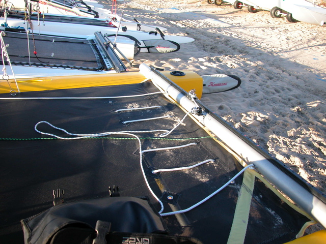

I'm looking for some photos of a traveler sheeting system that has the cleat and pivoting guide eye mounted on the rear crossbar, such as the Inter-20 or Hobie Tiger. I'm proposing a change to the H-20 traveler that would allow this and need some pics to publish in the newsletter. I'd go take my own photos, but it's winter here and everyone has thier boats under wraps.

In the pictures you see a Ronstan RF67 360 degrees swivelcleat (max 8 mm line) and this works beatifully. I use 6 mm line for my traveller and that is perfect for my boat and I-track traveller rail (F16). I can't imagine any boat no matter how big the mainsail would go over 8 mm line. (25.2 mm = inch so do the conversion yourself)
Also note that the foot piece for the cleat is nothing more than a standard 3 mm alu extruded L section (not anodised, that is not really needed) that you can buy at your local hardware store. One side of it was bend and hammered into the beam shape by the builder. It used (from memory) 3 monel rivets to keep it into place. I'm quite satisfied with the end result.

Do you have a closeup like the lower shot, but showing the traveler and sheet routing?

Anyways the bottom picture shows all there is to see. The rest is exactly the same as the system you have now, but with the cleat removed from the car.
